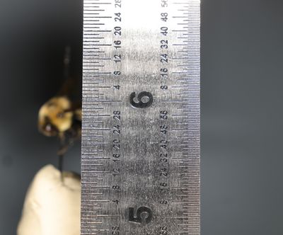

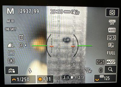

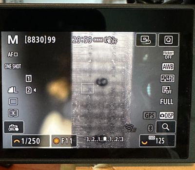

This is the LCD.
This is a screen shot from the CamRanger.
This is the pic I took on this view.
I hope these pics show you what I am dealing with.

@Waddizzle I was thinking the same thing. Canon focuses with the lens wide open. Exposure Simulation is with the lens wide open also. So if you’re looking through the EVF or at the LCD screen. Things are going to appear soft and or out of focus. Pressing the depth of field preview will stop down the lens aperture. Allowing you to see the true depth of of field.
