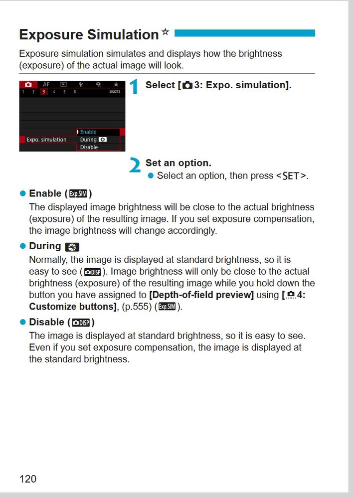

If you are in one of the creative modes, you might try playing with the exposure simulation:

In all my shots the sun is never in the photograph. I have absolutely no clue what exposure simulation is -- if it's a feature on my camera, then I've never used it. I'm using an adapter so that I can use my dSLR lenses on the mirrorless camera. It's labeled "Canon Control Ring Mount Adapter EF-EOS R."
