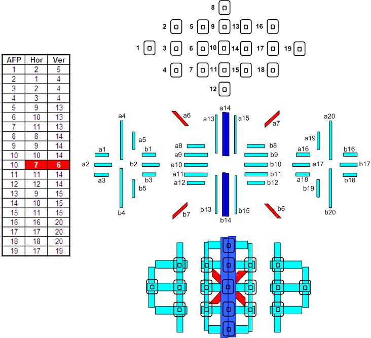

@Molybdo42 wrote:No, sorry, you didn't understand the purpose of the test.
The purpose is to see if the camera can lock focus on the portions I've highligted in red in the following picture :
None of your "real world" test answer my question. That is why I'm asking you to do the test in front of a computer screen and on a tripod. I'm making this to isolate the issue, the protocol is made in order to avoid the camera locking focus behind ornemental grass.
On my camera the focus points N°3 and 14 wouldn't lock focus.
Okay, I think I see what you're talking about. However, I hate to say this, but nothing is wrong with your camera. The focus system from the 7D and the 70D are shown here. Read the following for a bit more information and let me know if you need further clarification.
thus you can see where if you're going to shoot a person and want to focus on their eyes, in landscape mode it's important to select teh correct focus point AND to understand how they work. You may be a bit put off by the above, but rotate through the zones of focus points and you'll see that they favor top, bottom, left, right and center.

Yes I've seen that picture. Like I said in another post, I'm already aware that the focus sensitive strips extend quite a bit in certain direction and that it doesn't cover certain areas (http://forums.usa.canon.com/t5/EOS/EOS-70D-focus-issue-question/m-p/97566#U97566)
This guy did a similar measurement as me on his 7D :
http://blogs.stonesteps.ca/showpost.aspx?pid=54
He has better results than mine and the sensitive strip covers entirely the focus points I pointed to in my last posts. If
you look at any of his points, his camera AF covers a wider area and is more centered than mine.
To map the sensitive area, the measurement protocol I proposed (the long one, not the quick test) has been made to be the most precise and reproductible as possible (this is why it's long and requires a computer screen). Ididn't put rectangles randomly where I feel would be great, what you see is where my camera can focus ! You unfortunately have to admit that at least my 70D is defective with focus issues.
Also, since the 70D doesn't have the same AF modes as the 7D (for example no spot focus) I wanted to know how the AF would behave in a working 70D. Maybe Canon disabled some pixels in the AF sensor to make the coverage smaller. Nevertheless, the focus coverage in my 70D is decentered (just look at the center point !) and doesn't cover Liveview's marks, so in my opinion my 70D AF sensor is misaligned.
Seing the insidious nature of the AF issue, I'm counting on using the AF coverage to spot reliably the issue, even without a fast lens. This is what I'm desperately trying to explain...
I did the same kind of measurements on my 60D and all my 9 focus points where covering the marks in LiveView. I don't have the picture on this hard drive so I'll try to remake the measurement to post the result here.

08-08-2014 08:51 AM - edited 08-08-2014 09:10 AM
@Molybdo42 wrote:
Look at the pictures in these post, and tell me if that's how a camera's AF is supposed to work :
http://photography-on-the.net/forum/showpost.php?p=16974971&postcount=832
^^ The photographer had poor technique. Seriously, to focus on the side of a subjects face like that is not how the photographer is supposed to work. The AF Worked fine. Not flaming the guy, but if he understood how the AF System functions, such a mis-fire would not have bene unexpected. Innocent issue, but nonetheless not the camaras issue. He should have placed that focus point squarely on the persons face. Also, anytime the exact focus point you are targeting is small and perhaps the focus point extends outside the target, one has to be aware of the size of the focus points reach. Again, you're studies are giving you a crash course on that matter.
Even just today, playing around as I watered flowers, I was shooting with the intent to hit the center of a flower but the center was so small it fit completely inside the focus point. One would think, great! it beeped, I nailed the shot.....nope, it focused on the white petals behind my intended target because of their greater contrast and the alignment of them with the edges of the focus square. I didn't have enough DOF so at 100% it was slightly OOF. Not a big deal as it was a playing around shot that the OOF was minor and wouldn't be seen at even 8x10 size. However, we are all pixel peepers anymore it seems, even me.
I knew that was likely going to be the case as I've been there done that, so I simply flipped to Live View, zoomed to 5x insuring that not only was the focusing system targeting the center precisely but it allowed for me to visually see it do so better than just through the OVF. The latter being a nice benefit to the 70D's focus system.

08-08-2014 09:36 AM - edited 08-08-2014 09:50 AM
I'll add another piece of information, unlike older Konica Minolta 7D (http://photography-on-the.net/forum/showpost.php?p=16947213&postcount=719), Canon doesn't have three adjustment screws to level the AF sensor ! When assembling their AF sensor, they simply slap it on the mirror box and screw tight. For the 70D, the only possible adjustment is to use a screw to move the sensor to the left or right.
So in other words,Canon is counting on the manufacturing precision of their mirror box and their AF sensor to do most of the job ! But this method seems to work... most of the times.
I once had to adjust the position of a split prism focus screen (with several layers of thin tape), I can say that 50µm does make a huge difference, maybe the AF sensor has similar tolerance.
