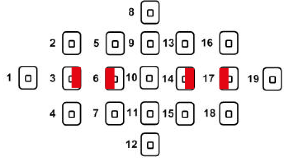

@Molybdo42 wrote:
No, sorry, you didn't understand the purpose of the test.
The purpose is to see if the camera can lock focus on the portions I've highligted in red in the following picture :
zones of interest
None of your "real world" test answer my question. That is why I'm asking you to do the test in front of a computer screen and on a tripod. I'm making this to isolate the issue, the protocol is made in order to avoid the camera locking focus behind ornemental grass.
On my camera the focus points N°3 and 14 wouldn't lock focus.
Okay, I think I see what you're talking about.  However, I hate to say this, but nothing is wrong with your camera.   The focus system from the 7D and the 70D are shown here.   Read the following for a bit more information and let me know if you need further clarification.
http://photo.stackexchange.com/questions/41174/if-the-focal-plane-is-curved-should-the-outer-af-poin...
thus you can see where if you're going to shoot a person and want to focus on their eyes, in landscape mode it's important to select teh correct focus point AND to understand how they work.   You may be a bit put off by the above, but rotate through the zones of focus points and you'll see that they favor top, bottom, left, right and center.
Yes I've seen that picture. Like I said in another post, I'm already aware that the focus sensitive strips extend quite a bit in certain direction and that it doesn't cover certain areas (http://forums.usa.canon.com/t5/EOS/EOS-70D-focus-issue-question/m-p/97566#U97566)
This guy did a similar measurement as me on his 7D :
http://blogs.stonesteps.ca/showpost.aspx?pid=54
He has better results than mine and the sensitive strip covers entirely the focus points I pointed to in my last posts. If
you look at any of his points, his camera AF covers a wider area and is more centered than mine.
To map the sensitive area, the measurement protocol I proposed (the long one, not the quick test) has been made to be the most precise and reproductible as possible (this is why it's long and requires a computer screen). Ididn't put rectangles randomly where I feel would be great, what you see is where my camera can focus ! You unfortunately have to admit that at least my 70D is defective with focus issues.
Also, since the 70D doesn't have the same AF modes as the 7D (for example no spot focus) I wanted to know how the AF would behave in a working 70D. Maybe Canon disabled some pixels in the AF sensor to make the coverage smaller. Nevertheless, the focus coverage in my 70D is decentered (just look at the center point !) and doesn't cover Liveview's marks, so in my opinion my 70D AF sensor is misaligned.
Seing the insidious nature of the AF issue, I'm counting on using the AF coverage to spot reliably the issue, even without a fast lens. This is what I'm desperately trying to explain...
