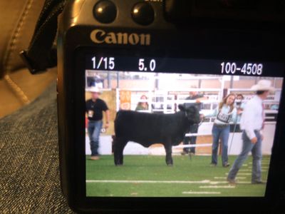

05-28-2021 10:55 AM
05-28-2021 11:03 AM
Yes I see your SS is far too low. Keep the FL to SS about the same. Example, at 55mm try to be at or above 1/55, probably 1/60 on your XSi. At the 250mm end you need to keep it at or above 1/250 or the closest next higher SS.
I did not see your ISO setting in the samples but it needs to be a high number, too.
05-28-2021 11:06 AM
Keep in mind all camera/lens gear has it limits. With what you have and not having the ability to alter or add more light to the arena, you may have exceeded the limits of your gear.
05-28-2021 10:54 AM
"I am trying to use TV mode and it is a long lense ..."
Most likely the wrong mode to use for what you are doing. Try P mode first off with a high ISO number. Keep in mind as ISO numbers go up, usually grain will begin to be more apparent. It may or may not be a problem. Depends on what you expect and want.
If you have a lens with a long focal length (FL), say 200mm+ it may be impossible to get super sharp indoor photos. Where you are shooting from can also be an issue. Closer is always better. Try making sure the shutter speed (SS) matches your focal length (FL). I.E., a FL of 200mm should have a SS of at least 1/200.
The solution is more light, a faster lens and/or a better ISO ability camera. Simple! Good luck and do show some samples as they might help with a better resolution to the problem.
