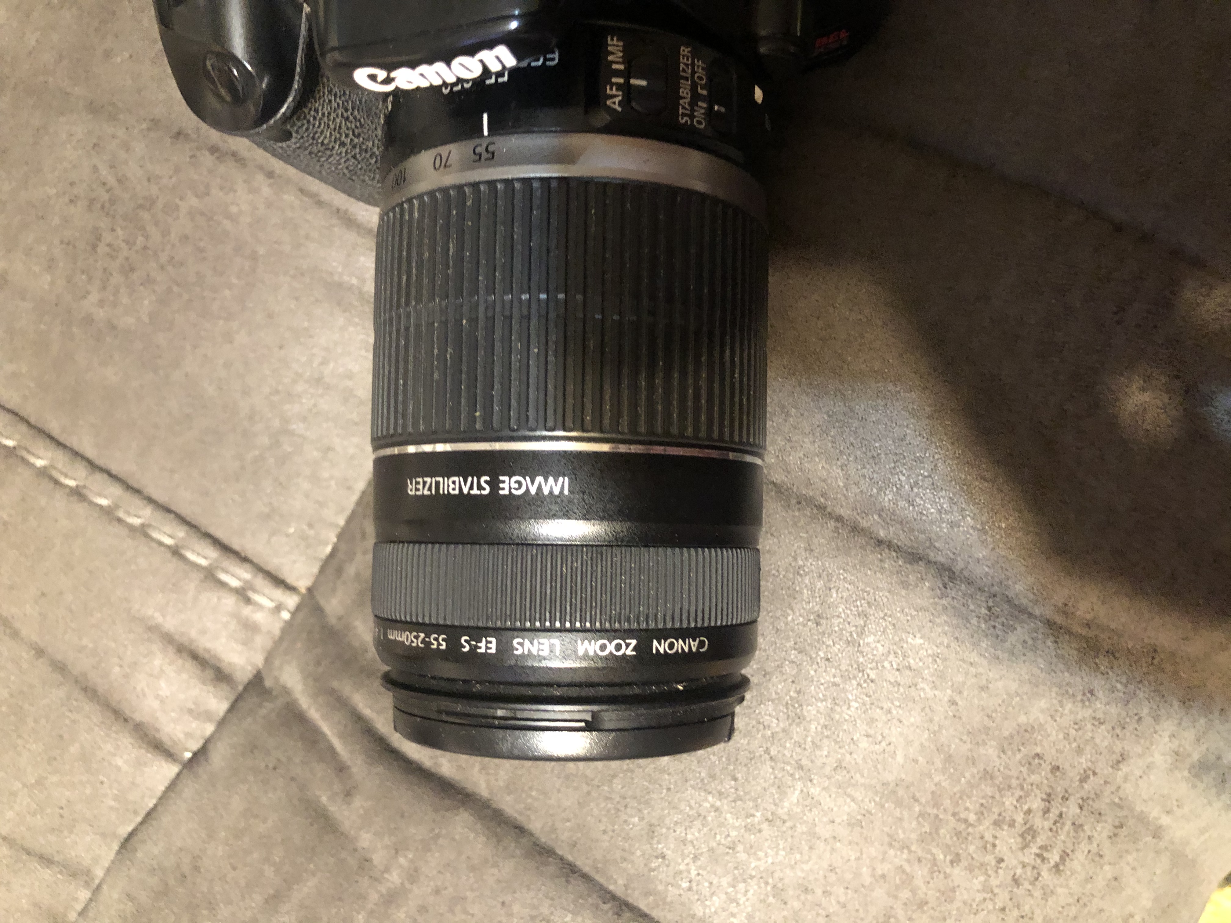

As Ernie mentioned, your shutter speed is way too low for that particular lens and venue. It appears to be the original kit lens, which although pretty good at the time, has fallen way behind in both image quality and image stabalization (IS), the latter being the most important in your situation. The newer model has an "STM" focus system (and better IS), and I don't see that [STM] on the lens.

I am going to guess that you need to set the ISO to the max - which is not very high on an XSi - and try to get a 1/200 focal speed or so. What is the focal length of your lens?

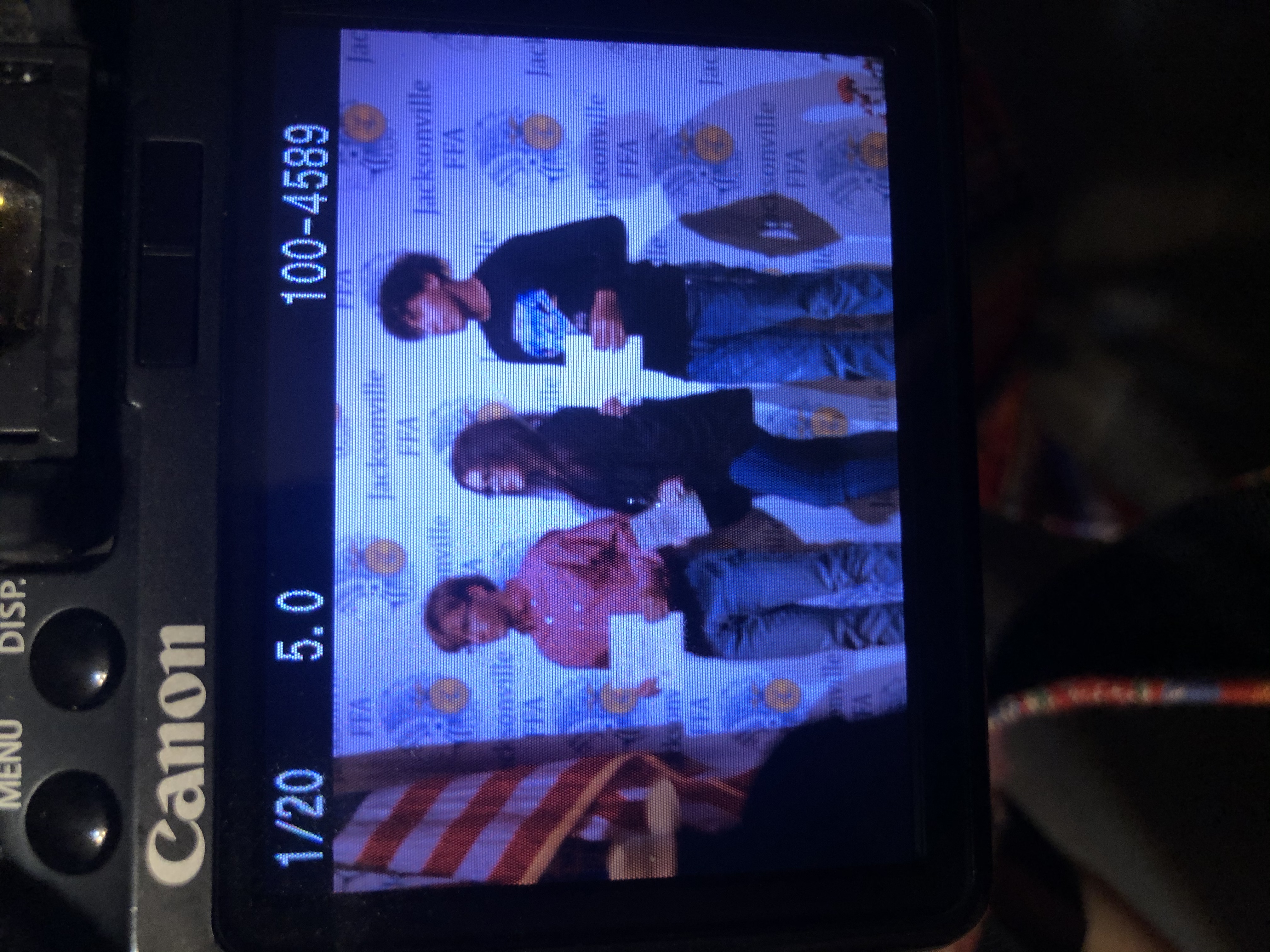

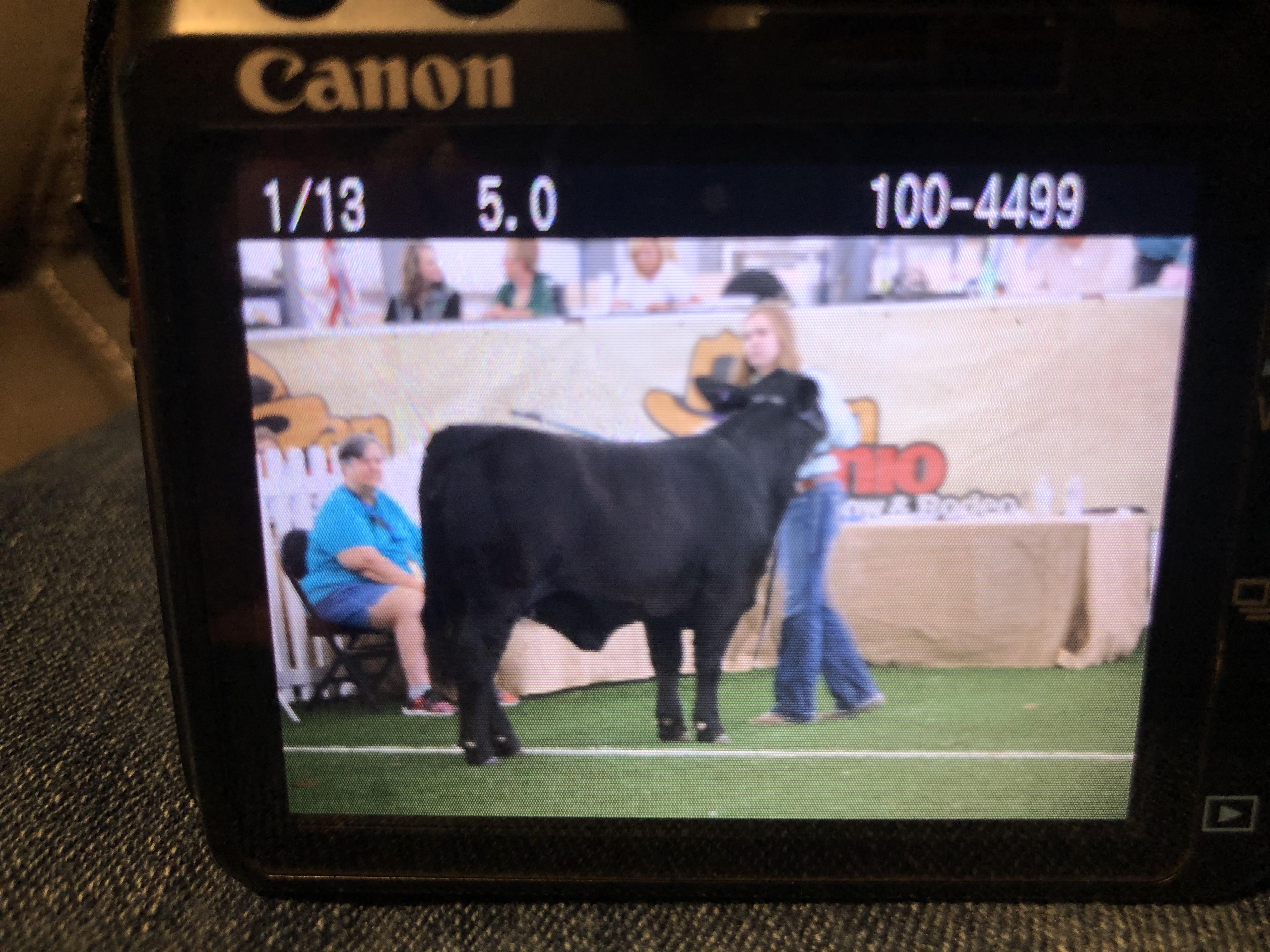

I will take pictures of it tonight, I am extremely new at this. This was my mother in laws camera, she passed away and my father in law gave it to me. I am trying to use TV mode and it is a long lense ( i think i'm using the right word)

Perfect. I'm sure someone will be able to give you some tips to try. A balance of ISO and shutter will probably be the answer. Also, which lens (brand/mm).

"I am trying to use TV mode and it is a long lense ..."
Most likely the wrong mode to use for what you are doing. Try P mode first off with a high ISO number. Keep in mind as ISO numbers go up, usually grain will begin to be more apparent. It may or may not be a problem. Depends on what you expect and want.
If you have a lens with a long focal length (FL), say 200mm+ it may be impossible to get super sharp indoor photos. Where you are shooting from can also be an issue. Closer is always better. Try making sure the shutter speed (SS) matches your focal length (FL). I.E., a FL of 200mm should have a SS of at least 1/200.
The solution is more light, a faster lens and/or a better ISO ability camera. Simple! Good luck and do show some samples as they might help with a better resolution to the problem.

05-28-2021 11:03 AM
Yes I see your SS is far too low. Keep the FL to SS about the same. Example, at 55mm try to be at or above 1/55, probably 1/60 on your XSi. At the 250mm end you need to keep it at or above 1/250 or the closest next higher SS.
I did not see your ISO setting in the samples but it needs to be a high number, too.
