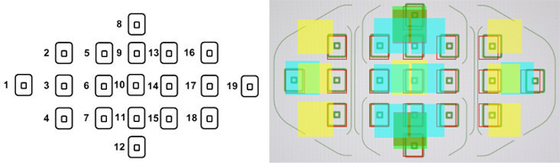

Most importantly, can you please comment on the fact that I can't focus when using the right half of some of my focus points ? (focus points number 2, 3, 4, 13, 14, 15 to be specific). Would a normal 70D behave like that ?
focus point number Af area

The right vertical side of focus points N°3 and 14
The left vertical  side of focus point N°6 and 17
Seing my measurements, I would have excpected those four focus points to be symetrical and to cover the entire marks under Liveview.

No, sorry, you didn't understand the purpose of the test.
The purpose is to see if the camera can lock focus on the portions I've highligted in red in the following picture :
zones of interest
None of your "real world" test answer my question. That is why I'm asking you to do the test in front of a computer screen and on a tripod. I'm making this to isolate the issue, the protocol is made in order to avoid the camera locking focus behind ornemental grass.
On my camera the focus points N°3 and 14 wouldn't lock focus.
Of course, you need to put the black/white edge inside the red rectangles...
If you can't do it don't worry, I'll do it once my 70D gets fixed, if it gets fixed someday...
