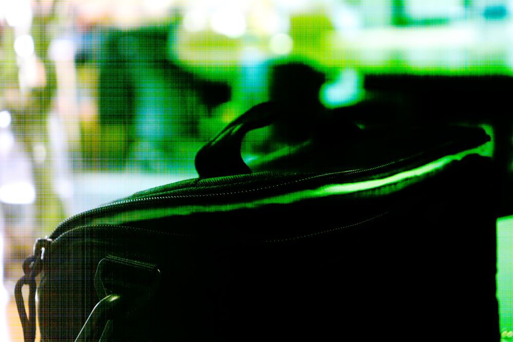

We are having an issue with an EOS Rebel T8i that appears to be almost randomly showing some kind of visual artifacts. It seems to be loosely related to if the shot is too under or over-exposed, but I was unable to accurately confirm that.
I've also recorded video with the camera lens on so there is no light reaching the sensor, and this makes the problem more visible: https://streamable.com/kjxl1o (the subtle spin is the image stabilization, I was rotating the camera slightly to see what the IS would look like with whatever is going on here)
I have tried doing a factory reset on the camera, as well as turning off all image processing-related settings, but nothing has worked unfortunately. This almost seems like a defect to me, but does anyone else have ideas as to what could be causing this?

Thank you. Still a bit early to make a concrete conclusion. The green cast in the example photo you provided looks very much like an incorrect white balance setting, yet you indicated you have reset the camera to defaults.
Canon lenses and SanDisk High Quality SD cards. As long as the cards were purchased from a reputable source, no reason to suspect them at fault. So the camera works after a reset, but photos gradually deteriorate into the greenish tint/cast we see in the photo above?

It seems like resetting the camera isn't affecting the distortion, at least as far as I can tell. In areas where it can properly focus (well-lit environments with distinct details), it takes excellent pictures and I can't see any artifacts/distortion like what was pictured above. But, the distortion will appear while it is in the process of refocusing, and in very low light it will appear almost constantly.

What I strongly suspect. This is either a sensor or PCB (power board) issue. I'm sorry, but the camera will require service.
