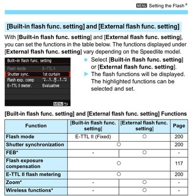

Here is the T7 user manual that shows how the flash mode is locked to ETTL II when using the built in flash.

There is no way to change the ETTL mode on a T7. The T7 is a “beginner” camera that is stripped of many features in order to be both simple to use, and cheap to buy. The lack of a Manual flash mode is one of many missing features.
You might be able to add an external flash to the hotshoe in order to trigger your strobes, but once again, since the T7 is stripped down, it is missing the center flash sync contact in the hotshoe, so that will complicate matters.
Since you are advanced in your photography skills, I would advise you to look at getting another camera with more features. You may have saved money buying a stripped down camera, but if it can’t work for you, it’s false economy.
