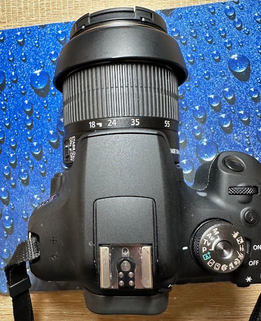

You said the T7 "...it is missing the center flash sync contact in the hotshoe". My T7 appears to have a center flash sync contact and the 4 others that mate up with the contacts on the bottom of my 430EX flash (see the pic below). My presumption is that if I used a "dumb" sync cord or wireless flash trigger with only a one pin center contact, I could fire studio strobes as long as I set the camera up in manual for the proper shutter speed and aperture. I think it would be curious if Canon put a center sync on the T7 but did not hook it up to anything unless they always put the same hotshoe on every camera meant to work with a Canon EX series flash.
Although this won't help the OP, I was wondering if it would be possible to set off an optical flash trigger with a simple electronic flash with only a center contact (and low trigger voltage) or with an EX series flash set to manual?

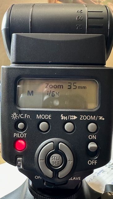

I've attached a pic of the shoe of my 430EX to show that it also has the center contact and a pic of my 430EX's screen set to what I'm guessing would work (or asking you if it would work) if I set the flash to M and dialing down the power to a low output but still enough to set off the optical trigger?
In my film days, I had a 10s with a 540EZ and put a Vivitar 283 on a stand with an optical trigger that I would use for fill flash, to light the background or try to be creative. I realize the EZ flash technology is different than EX E-TTL technology but wonder if the using my current camera and flash instead of the 10s/540EZ would work the same way? It's a hypothetical question, but I'm still curious.
Also, I've taken photos with the flash in M and adjusted the power level on the flash to a level that properly exposes the photo so I assume that the T7 is not in TTL in that situation - correct?

10-12-2023 08:52 PM
Manual flash is only applicable to an external speedlite. Not the built-in flash. Some Rebel T7 and other lower end cameras don't have the center contact on the hot shoe. The 430EX series speedlites can only be an optical receiver/ slave. It can't be a sender/ master speedlite. Only the 580EX series, 600EX series & the EL-1 can be a sender/ master speedlite. For Canon E-TTL & TTL are 2 completely different and incompatible systems. Canon's speedlites don't need the center contact to work. They rely on the other 4 contacts to work. Older EX series speedlites are compatible with both E-TTL & TTL. But only 1 mode can be selected depending on the camera. Some EOS Film bodies support E-TTL.
