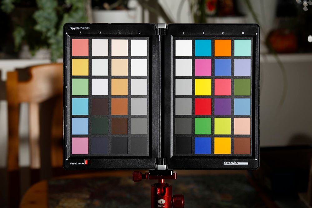

I have some raw samples from R6, 6D and a Spydercheckr. CC0 license for the raw files. Feel free to use them as you like.
0582 is 6D ISO 100
0583 is 6D ISO 3200
8924 is R6 ISO 100 c-raw
8930 is R6 ISO 3200
8932 is R6 ISO 100
https://drive.google.com/file/d/1_aQmGvoGVrfycp0CFwhDhe6Q5TxyqDcC/view?usp=share_link
R6 DPP4
6D DPP4
