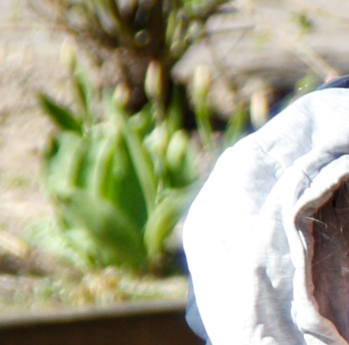

I was noticing on a recent sports event that my R6 paired with my EF 24-105 f/4 (vello adapter) showed significant chromatic abberation (I think) -- see attached image.  The R6 settings for abberration are ON.  I've not seen this before.  Anyone experience this ?

No filter although the vello adapter may be not what it was when i got it a year ago.
Isn't the adapter a hollow cylinder? Not sure how that would affect your images.

It is, but compare the Canon adapter with the Vello adapter and how they look inside.
I took a look at all my pictures taken with the EF 24-105/4L IS USM. I found one similar to OP. Blue channel clipped in the raw file. extraced with Hraw.

Your raw file on the other hand doesn't have clipped highlights in the raw file at that place. I am guessing the same as jrhoffman75, blooming.

I think what you are seeing is "blooming".
DPP reports the RGB values of the area around the edge of the helmet and shirt as 255,255,255 (i.e. locally blown out).
That is so peculiar looking compared to the histogram.   !!!
I think it is the clarity of display of histogram in DPP. LrC shows the histogram going all the way to the right at very low level.
Mousing over the edge of the shirt shows 97+% in LrC.

IMHO, it is not blooming nor CA. The causes of those two are just not there. Just for fun I would get a real Canon adapter.

Having a similar issue with the same setup except using the canon adapter. Took it back to the camera shop, Hunts Photo, they found the same issue outside in bright sunshine. I’m going to send it to Canon to check it out along with some raw images
