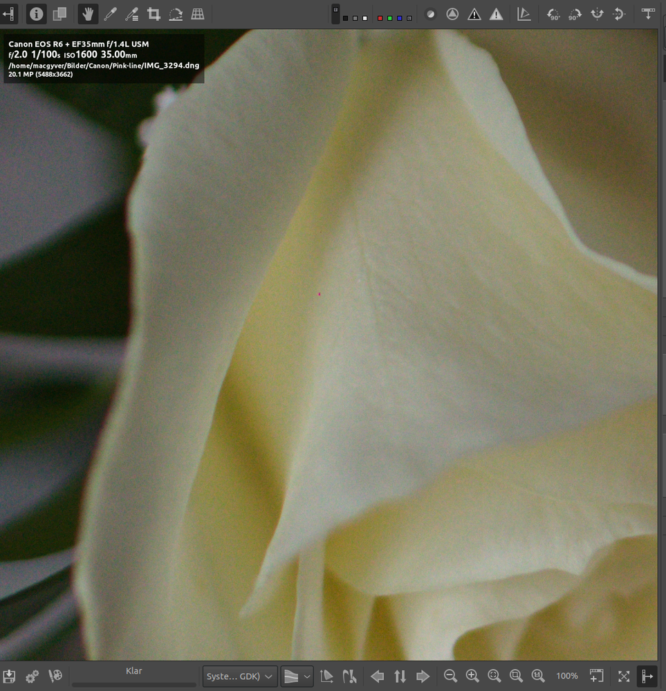

Affecting two columns beside each other and gets stronger a bit down. No idea how to fix that. Perhaps a bad pixel filter https://rawpedia.rawtherapee.com/Dark_Frame#Bad_Pixels
or Pixel fixer if you convert to DNG http://www.pixelfixer.org/

Pixel fixer didn't support your raw file.
RawTherapee worked but doesn't read Exif from CR3. I converted first to DNG.
To me it seems like your sensor has been exposed to a laser. The purple dot/dots.
Anyway, I created a badpixel file and named it Canon EOS R6.badpixels
I used LibreOffice Calc to generate the numbers.
x1466,y0
x1466,y2
x1466,y4
etc...
I noticed the columns and every second pixel in each.
Badpixel file to put in your dark-frames directory https://drive.google.com/file/d/1pSkGYZ-8N1bdegbKmjbDn6iXCxDUQ0nd/view?usp=share_link
Still a visible line at the bottom.
There are some more purple dots to be marked as bad pixels and at the bottom a line is still visible.

Thank you so much for your help. so I'm trying to export them as DNG's to begin with and lightroom doesn't seem to be exporting them. did you use lightroom to export it?
01-11-2023 10:36 PM
I used Adobe DNG Converter to convert, but you may try to load the original CR3 files also in RawTherapee 5.9.
01-13-2023 05:27 AM
New updated badpixel file https://drive.google.com/file/d/1bgL75LLHZI6sIOrgm9Ov7NnxKIg-QpeN/view?usp=share_link
Removed the line and removed more purple dots.
