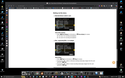

The image below is a screenshot of the manual.  My actual camera menu only shows Card 2.

You need to go to the yellow wrench menu section and first choose one card for playback and then the second.
Screen Shot 2025-07-08 at 06.55.46.689 PM.pngScreen Shot 2025-07-08 at 06.55.46.689 PM.png
