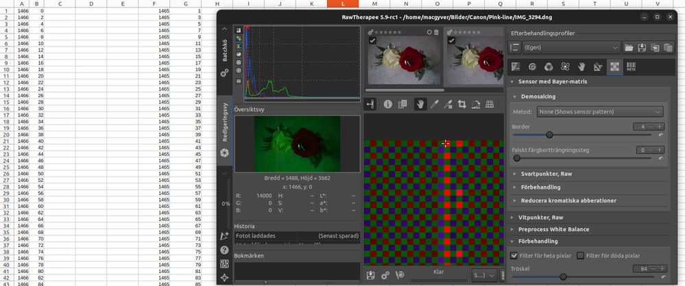

Affecting two columns beside each other and gets stronger a bit down. No idea how to fix that. Perhaps a bad pixel filter https://rawpedia.rawtherapee.com/Dark_Frame#Bad_Pixels
or Pixel fixer if you convert to DNG http://www.pixelfixer.org/

Pixel fixer didn't support your raw file.
RawTherapee worked but doesn't read Exif from CR3. I converted first to DNG.
To me it seems like your sensor has been exposed to a laser. The purple dot/dots.
Anyway, I created a badpixel file and named it Canon EOS R6.badpixels
I used LibreOffice Calc to generate the numbers.
x1466,y0
x1466,y2
x1466,y4
etc...
I noticed the columns and every second pixel in each.
Badpixel file to put in your dark-frames directory https://drive.google.com/file/d/1pSkGYZ-8N1bdegbKmjbDn6iXCxDUQ0nd/view?usp=share_link
Still a visible line at the bottom.
There are some more purple dots to be marked as bad pixels and at the bottom a line is still visible.

I used Adobe DNG Converter to convert, but you may try to load the original CR3 files also in RawTherapee 5.9.
x1466,y0
What do you mean by badpixel file? Is this needed to use Rawtherapee?

New updated badpixel file https://drive.google.com/file/d/1bgL75LLHZI6sIOrgm9Ov7NnxKIg-QpeN/view?usp=share_link
Removed the line and removed more purple dots.
