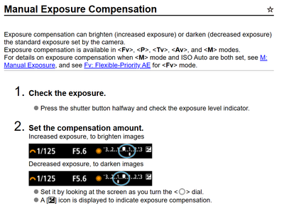

I found this in the manual. Adjust Exposure Compensation using the dial
For AEB, you have to define or set a range (bracket) using the camera's menu. Then you use the dial to set EC on the fly (when shooting). Three bracketed shots are taken, according to the specified drive mode, in this sequence: Standard exposure, decreased exposure, and increased exposure.

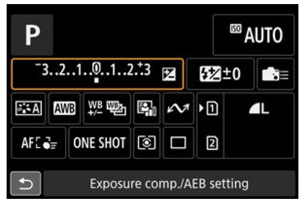

AEB has always been a little used technique for me, so I never gave it much thought as to having a custom button, but I can see it being useful if you do it a lot. With that said, the way I do it on the R6 mark II is press the Q button then tap the exposure compensation bar then I can use the main dial to set the AEB spread or the QC 2 dial to set exposure compensation. It's pretty quick.

Thanks for the replies, but I'm still puzzled. My question is about AEB, not EC. I don't see any way to access AEB without going to the menu. I had a way to do it on my 5D III and 5D IV, via Q. Whiz: my camera doesn't have an EC option for the Q menu. The 5Ds did. I just put it one of my own menus in the green section.
05-16-2023 03:24 PM - edited 05-16-2023 03:34 PM
@dkoretz wrote:"Whiz: my camera doesn't have an EC option for the Q menu."
It depends on the screen you have displayed. My wife uses the plain INFO screen on our R6 mark II, since there is no top LCD, which turns off when she looks through the EVF. If you are in live view, Q will not display the EC/AEB bar. Toggle the INFO button until you get a plain rear display.
If you use live view or are using the level, the green menu might be quicker for you (before and after), but this works for us.
I will add that selections on this screen, when using Q, are "sticky", i.e. the next time you press the Q, your previous selection is still active. So if your last selection used was AEB, all you have to do is adjust the main dial if you want to adjust AEB spread.

05-17-2023 11:59 AM
Newton--
Bingo! Thank you. exactly what I was looking for. This replicates what I had on the 5D IV. One thing that I missed is the little new Q button at the bottom left, without which I wasn't able to navigate through the info screen except within one row.
