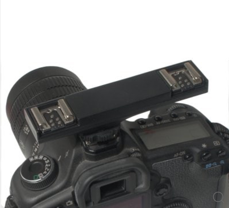

You are not out of options.  Photographers are a resourceful bunch and I am sure there is a solution available for you.

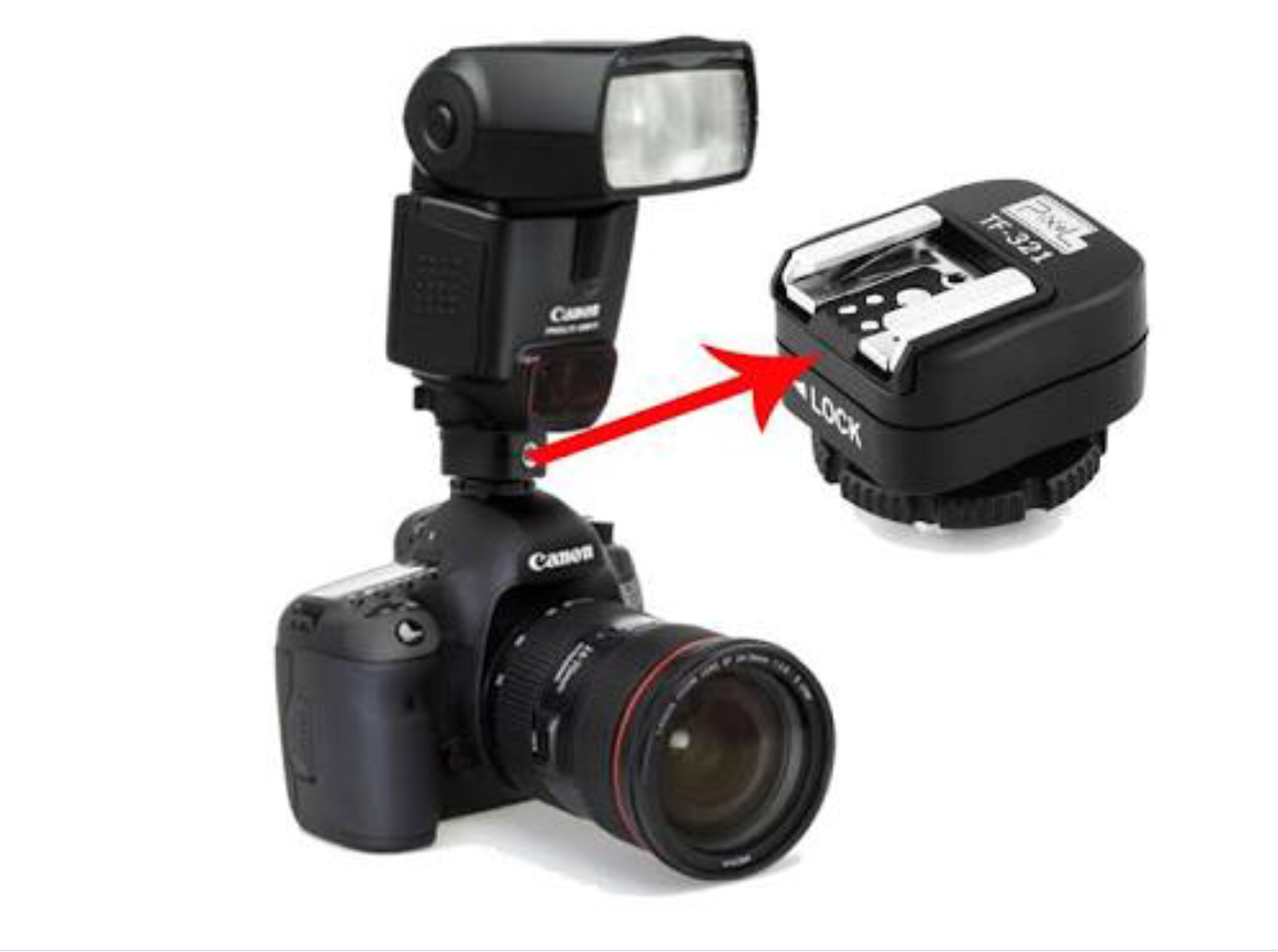

This may be exactly what you need. [link removed per forum guidelines]
There are other PC adapters designed to ADD a PC connection to your 6D.

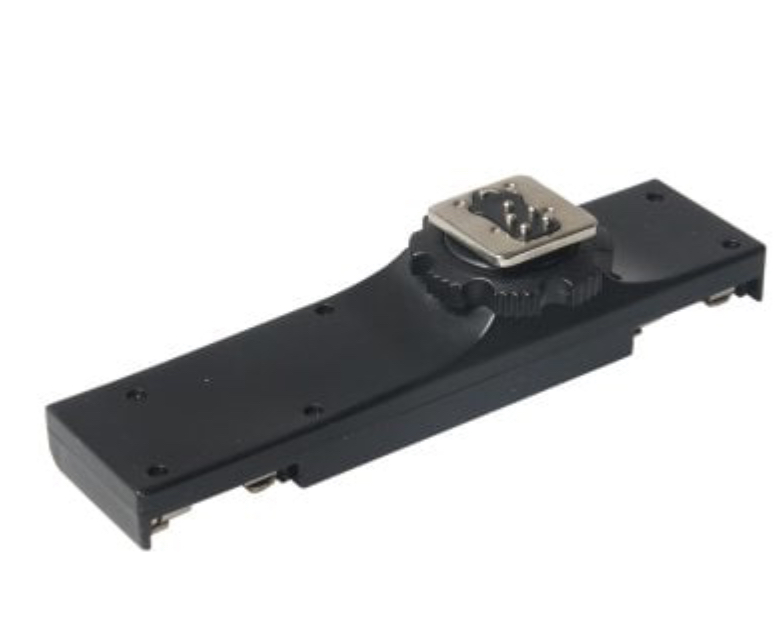

You could also also use an ETTL cord with a built-in shoot through hot shoe.

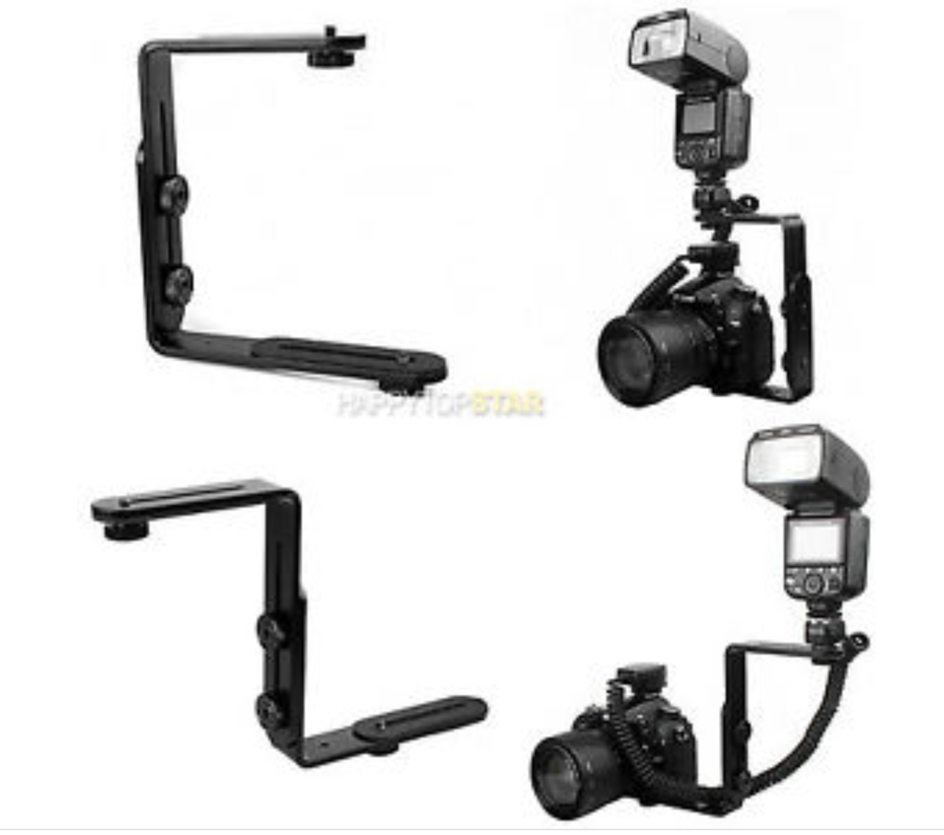

Another option is a bracket system attached to the bottom of the camera which can free up the hot shoe.

I think the bottom bracket with the flashes on either side of the camera looks like a great option right now.
Am looking for a tripod mounting screw long enough to run through the bracket and lock in the camera. If you know of a link, please search, until then, I am searching now.
