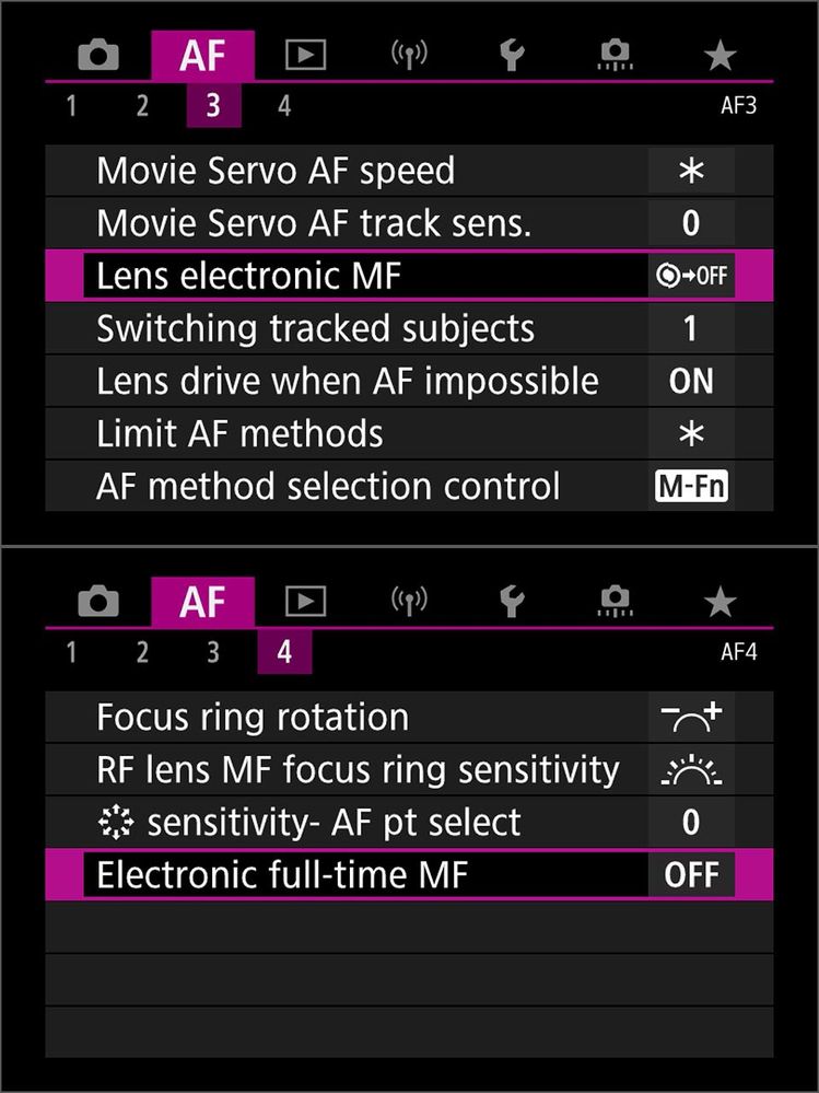

This option allows you to manually focus with RF lenses even when autofocus is active, but this option is not working on the R8, as it does on my other R6 and R10 cameras.
Anyone experiencing the same problem?

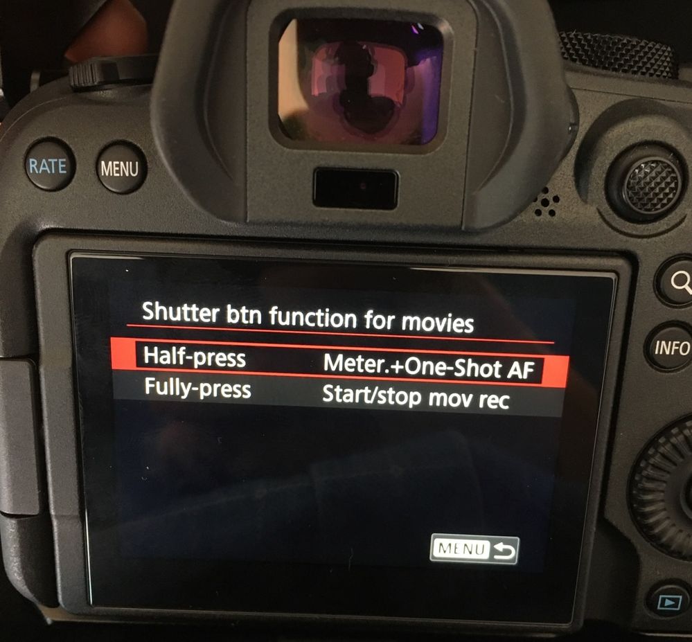

So taking that and the idea that my EOS R6 and yours worked differently I wondered if the back button thing also applied to movies. You can't customise the shutter button for movies but I recalled that the shutter button for movies is separately configured. So I set to work and can now do full-time manual focus with any RF lens on my EOS R6, EOS R10 and EOS R6 Mark II. It also works with older EF lenses that have electronic focus rings like the EF 40mm f/2.8 STM, EF 85mm f/1.2L II USM etc.
The key is that the shutter button needs to be configured for metering only, then it's like you have configured back button AF that I covered in the other thread. First here is the screenshots from my EOS R6.
Movie shutter button function
EOS R6EOS R6
Setup for the lens electronic MF and Electronic full-time MF.
EOS R6EOS R6

The method you've described definitely helped me fix that "issue." I hadn't mentioned before that I'm focused more on video mode (since, due to my profession, I film more than take photos). I had slightly different settings than yours, but the key moment, as you figured out, was changing how the "Shutter btn function for movies" behaves!
Thank you again for resolving it! It had been bothering me for months (and I did my homework and research, which eventually led me here)!
