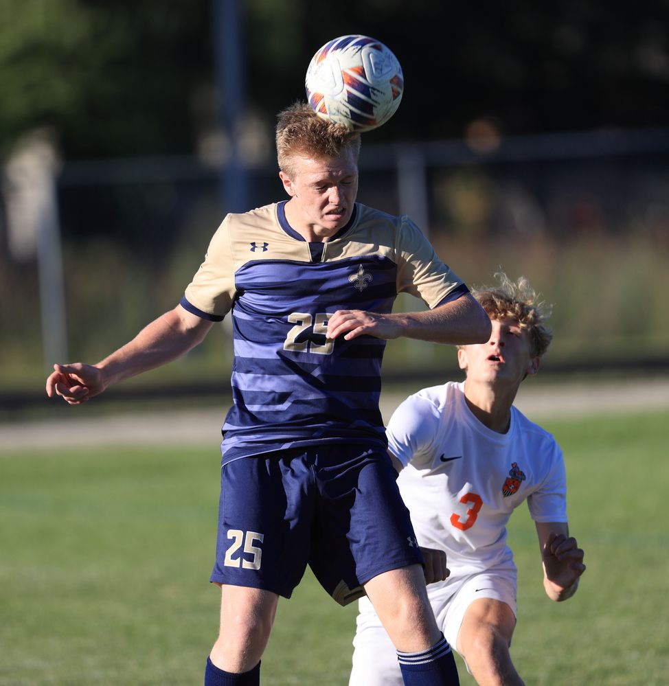

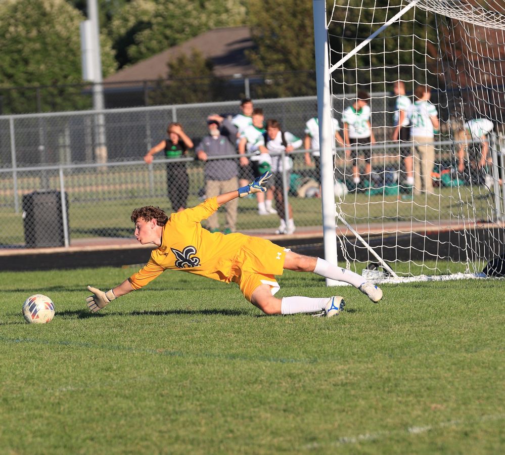

1/500 is about the minimum shutter speed for HS soccer, higher is preferable when light permits. I prefer setting cameras to manually select aperture (wide open, i.e. lowest f number available for the lens) and fixed shutter speed (1/500 or faster) with ISO set to auto to let it choose the proper exposure via setting ISO. Don't rely too heavily on the camera's high speed continuous mode, you need to time your shots to get the desired action because the camera frame rate is too slow to catch peak action in most sports.
The closer you can get to the field the better, in sports photography your location is critical and this is especially true when poor lighting forces a higher ISO with more noise making cropping less practical.
These were from a soccer match last week, not a lot of highlights for the home team unfortunately because only the keep got multiple chances to shine and that is never a good sign.
