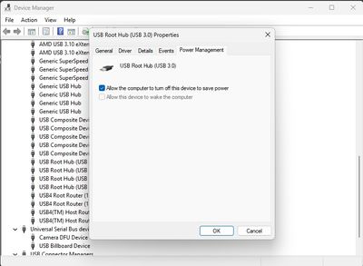

If you can find the correct USB Root Hub in Device Manager you can try unchecking "allow computer to turn off this device".   Probably need to reboot after that change and then confirm that it stuck.
I have monitors on USB hubs and using a KVM to switch between monitors and they disconnect via the Power Management "USB Selective Suspend".  Don't know if this will work, but perhaps worth a try?
If not, you might have to consider it a "feature" and save inside the camera.
Screen shot of Device Manager checkbox below.
