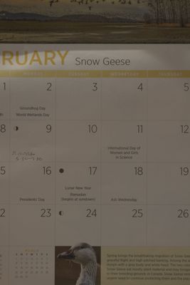

Hey yall, I picked up a used copy of a 100-400 ii a couple months back to 'upgrade' from my 400mm F5.6L prime. That lens was razor sharp and I loved it, but I wanted the zoom and the equal if not better sharpness from what I read online. At first I thought it was fine and that I was maybe just missing AF, but I had a hunch something was not right. On Saturday I photographed a bird swimming on a lake (clear background, bright direct light) and I noticed the pictures really were not sharp on zooming in. This is where I finally felt sure it was not just a skill issue. I tried going through AFMA on my 7d ii to figure out if it was back/front focusing, and while it did sometimes, that was not the whole issue. It seems on direct comparison to the prime, it is softer.
I will attach a direct comparison photo, it is of a calendar taken pretty much front on with 1/40s, F5.6, and ISO 1600. It is clear especially in areas like the bottom left that there is a lot of softness that almost resembles diffraction artifacts going on in the zoom. It is not motion blur, IS is off so it is not IS, the pictures were taken with a 10 second timer on a tripod so they are totally still. They were manually focused the exact same way, it is not AF. I have tried with and without lens hood, it is not caused by light on the front element.
The pictures are linked in this reddit post since I don't have them on this laptop and I can't upload .webp: https://www.reddit.com/r/canon/comments/1r6j2sf/comment/o5r9eei/

Hey guys, thanks. I did do a ruler test to evaluate front/back focusing possibilities first and while I don't have those images on me at the moment, there didn't seem to be any hugely significant issue there. Yes it seemed to be backfocusing a bit, but even focused correctly the sharpness still did not seem right. I am 99.9% sure this is not a focusing issue.

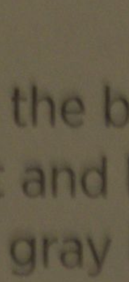

02-18-2026 01:46 PM
well here’s another test shot, I will be sending it off I think but thanks
