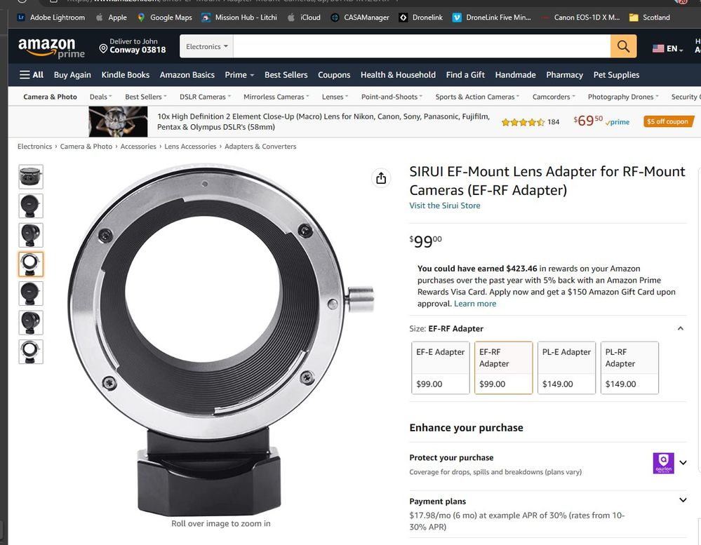

Is this what you have?
It's dedicated to the Sirui Jupiter lenses (whatever they are) and has no electrical contacts.
John, they are Anamorphic and Spherical cinema lenses. From the looks of their page, mostly Anamorphic.
