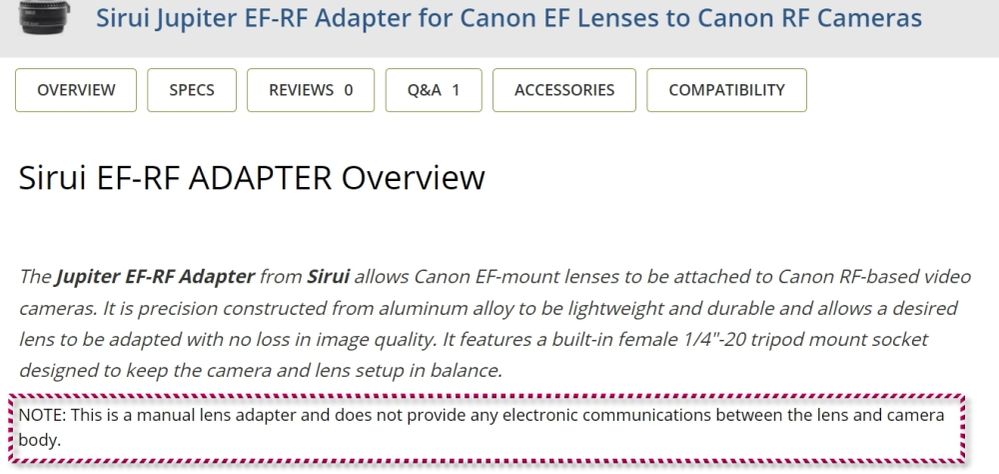

This adapter is made for Sirui Cinema lenses. With your EF lenses, there will be no autofocus abilities. Consider the Canon basic or ring type EF - RF converters over other 3rd party adapters after returning the Sirui 🙂
I'm really surprised that B & H didn't tell you that on your "Support" call. This is from their web site and is at the bottom on the INFO page for this adapter.
Per B & H Web Site.Per B & H Web Site.

jrhoffman75
Is this what you have?
It's dedicated to the Sirui Jupiter lenses (whatever they are) and has no electrical contacts.

FloridaDrafter
@TXMack wrote:
I have been a canon user for 15 years, Im no stranger to things canon and I'm fairly smart 😕
Purchased an adapter  SIRUI ef lens to canon RF mount adapter- so that I can use my current selection of lenses.
mounted lenses- ensured they were not in manual focus.. I cannot get AF.  I have gone through the menu (AF:1 and my only option is M)  I called B&H and we did a reset, still only M focus.  I opted to do a firmware update.  the r6 Mark ii doesn't seem to have a .FIR . so maybe its so new that it is still on v 1.0.0??
Im so bummed that I cannot get the focus thing figures out.. any suggestions?
Newton
They were the ones that recommended that to me!!! I’m going to try the canon OEM tomorrow 🤞🤞🤞
Crazy that this is what the rep on the phone told me to get😖
John, they are Anamorphic and Spherical cinema lenses. From the looks of their page, mostly Anamorphic.
