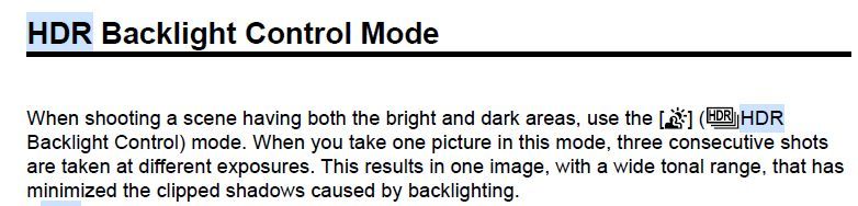

06-12-2022 08:33 AM
I have a T8i. The only way I know how to do this (aside from continuous shooting) is to put my camera in a Special Scene mode (SCN) called HDR Backlight Control Mode. Here's what the Manual says,

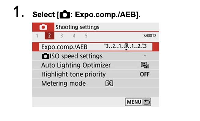

06-12-2022 08:14 PM
You need to read the advanced manual. the T8i has AEB, too, and it appears that it automagically takes the three images:
