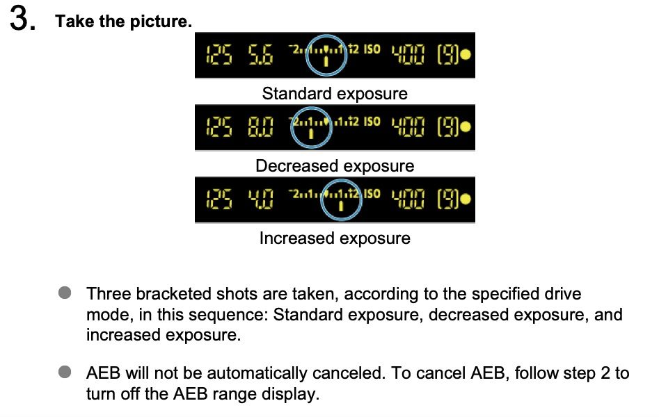

06-12-2022 08:14 PM
You need to read the advanced manual. the T8i has AEB, too, and it appears that it automagically takes the three images:
