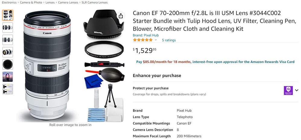

So, this?
[Commercial link removed per forum guidelines and replaced with screenshot to facilitate discussion.]
Or this one?
The lenses you posted are VERY good lenses I own both. When purchasing lenses you should look for a lens ONLY not a kit with filters and other accessories. Also ONLY purchase gear from a REPUTABLE website or store such as B&H Photo, Adorama, Canon Online Store. Amazon and Ebay ARE NOT REPUTABLE places to buy camera gear. If you shop from Amazon or Ebay you can't tell if the seller is selling you U.S. gear. If you get international gear also known as GRAY MARKET and if it breaks Canon WILL NOT WARRANTY IT OR REPAIR IT. So ALWAYS shop from Canon Authorized Dealers. The 24-70mm will have an angle of view 38-112mm and the 70-200mm will have an angle of view 112-320mm. The reason why the lenses act longer is due to your camera having an image sensor smaller than Full Frame/ 35mm Film. The 7D is an APS-C camera (22.5 x 15) with a 1.6x crop compared to Full Frame/ 35mm Frame (36 x 24).
