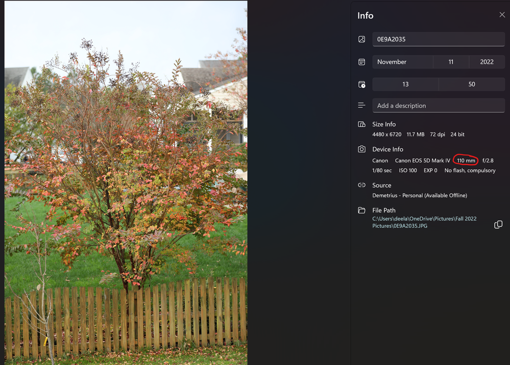

Focal length tells us the angle of view of how much of a given scene will be captured by the image sensor. Every lens has a focal length ie 18-200mm for a zoom lens. Or 50mm for a prime lens (fixed focal length lens). The zoom ring (if you're using a zoom lens) on your lens shows markings for all the available focal lengths 18mm, 24mm, 50mm etc. All lenses list focal lengths in millimeters even if your in The U.S. and other things in photography are listed in metric/ millimeters.

If you're not sure what focal lengths you've been using the camera attaches all of that info (EXIF Data) with the picture. If you've moved pictures from your camera to the computer all the info is there. Or if you haven't moved your pictures yet the camera will provide all of that info for you on the rear LCD screen. You can look at the closet and furthest focal lengths to determine what focal lengths you use the most. Or you can upload a few pictures with the metadata intact.
The number circled in red is what we need to better assist youThe number circled in red is what we need to better assist you
