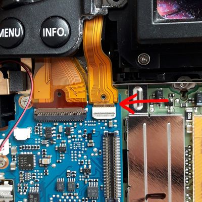

03-18-2017 08:51 AM - edited 03-18-2017 08:55 AM
I think I have the solution to your problem (at least one of the possible ones).
I noticed the same issue with my camera recently — SSID created (in other words, WiFi signal emitted) by my camera didn't show up anywhere on any devices (two different phones, Android one and an iPhone, as well as a WiFi adapter connected to my desktop PC). The camera also didn't detect any signals from nearby WiFi sources (just displayed 'Searching...').
In my case it was a hardware problem.
A short prehistory to my solution. I'm sort of a tech geek when it comes to DSLRs, and tend to teardown (disassemble) my gear once the warranty term has run out and when there's some trouble with it. So in this particular case the problem appeared to have been caused by the flex cable from the in-camera WiFi module not being properly re-inserted during reassembly. Simply speaking, I didn't put it firmly enough back in place on the mainboard when reassembling the camera after some sort of cleaning inside.
So now I disassembled the camera again, got right to the Wi-Fi module to check it and its close surroundings for any visible damage (had a wet shootout recently), detected nothing suspicious, and then during reassembly I simply put the flex cable more firmly in place. It's very subtle to see or to show, but just half a millimeter plays a huge role in this case. And it's somewhat difficult to insert it back, since you have to apply force to such a tiny detail. Anyway, problem was solved for me this way.
The only thing which bothers me now is that the camera self-diagnostic system didn't report any trouble with the WiFi module, which obviously wasn't functioning normally.
In your case it might not be the same cause. If you had your camera repaired and/or disassembled recently, the chance you have the same trouble is pretty high.
Sorry for the mistakes and/or for the 'long read'. See the attached image.
