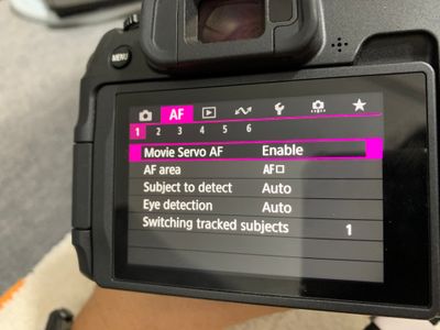

Hi Brian, this is my settings:
I've already tried to modify these settings but the camera still has the same video focus problem.

Canon has made some changes to the AF options in video. in the first image it was firmware 1.0.0 and in the second it was 1.2.0. This update “ruined” my option to use the camera to film. I really wanted to go back to firmware 1.0.0 but I couldn't find the file anywhere.
