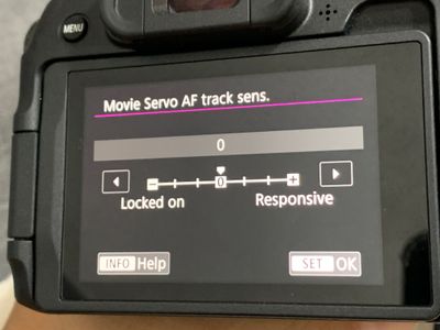

Next on AF2 what settings do you have for Movie Servo AF Speed, and also for Movie Servo AF track sensitivity?

Hi Brian, this is my settings:
I've already tried to modify these settings but the camera still has the same video focus problem.
Have you tried increasing the Movie Servo AF track sensitivity to make it more responsive?
