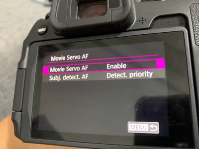

p4pictures
A couple of questions about the settings on your camera.
On the AF1 menu first entry is Movie servo AF, it should be enabled, but if you press set there is an additional option in addition to Movie Servo AF enable/disable. This additional option is Subject detect AF, and this has two option Detect. Priority and Detect. Only. If you have it set to Detect only the camera won't refocus if the subject moves out of the frame.
Next on AF2 what settings do you have for Movie Servo AF Speed, and also for Movie Servo AF track sensitivity?

Hi Brian, this is my settings:
I've already tried to modify these settings but the camera still has the same video focus problem.
Have you tried increasing the Movie Servo AF track sensitivity to make it more responsive?
