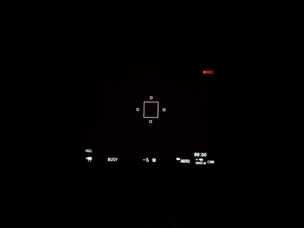

Anybody else having this problem with the Canon R6 freezing up. It usually starts with the camera not focusing. Its also becomes none responsive to mode changes. The on/off button doesnt work. Opening the battery door shuts it off... but still doesn't fix it. Pulling the battery out usually fixs the problem right away. But again... not always and sometimes it take a few battery removals to get it back up and running.
This has happened while shooting both photo and video. It happens with different lenses. It happens with different memory cards. I can't recreate the problem on command. The camera works 99% of the time. But at least once a wedding shoot, over the period of 6 hours, It freezes up!
In the video below... I was attached to the Ronin gimbal. But it's happened just shooting photos and without the gimbal. Plus, when I open the battery door and try and turn the camera on/off... it still doesn't work. Has nothing to do with that.
I was on firmware version 1.4
I updated the firmware this week to version 1.5.0.
This problem has been happening for a long time... 8 months. Camera is less than a year old.
Again, at last nights wedding... it froze.
Here is a video that I recorded when it happened.
1. Focus isn't working. Both back button and touch.
2. Display freezes up. You can still see the audio working.
3. On/off doesn't work.
4. open battery door... nothing works.
5. Pull Battery
