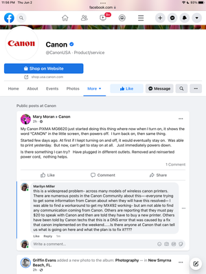

06-03-2022 12:18 AM
This is a widespread problem—-it is posted in this forum in several places….all of us are looking to see some response from canon- but so far crickets!! I found nowhere on their website to post anything…..BUT….I did find a FACEBOOK page-one other person had posted something-but no reply — I just posted…… suggest more people post a complaint on facebook in this page and maybe someone will actually answer it…..here is screen print of what i posted…..

06-03-2022 11:15 AM
UPDATE RE CANON’S RESPONSE TO FACEBOOK POSTS
A few people responded/commented on the post I put on the USA CANON page on FB yesterday…..the ONLY RESPONSE from. CANON however has been the REMOVE several of the comments….
The comments removed were respectful in my view- (one was my reply to one of the comments-my original comment is still there at this moment) -people indicated the problems they had and how they had tried to get help and resolve their issues…nothing awful or rude)
I guess we will never know how many people tried to get help on social media had the requests were simply erased
very disappointed in Canon, to say the least
