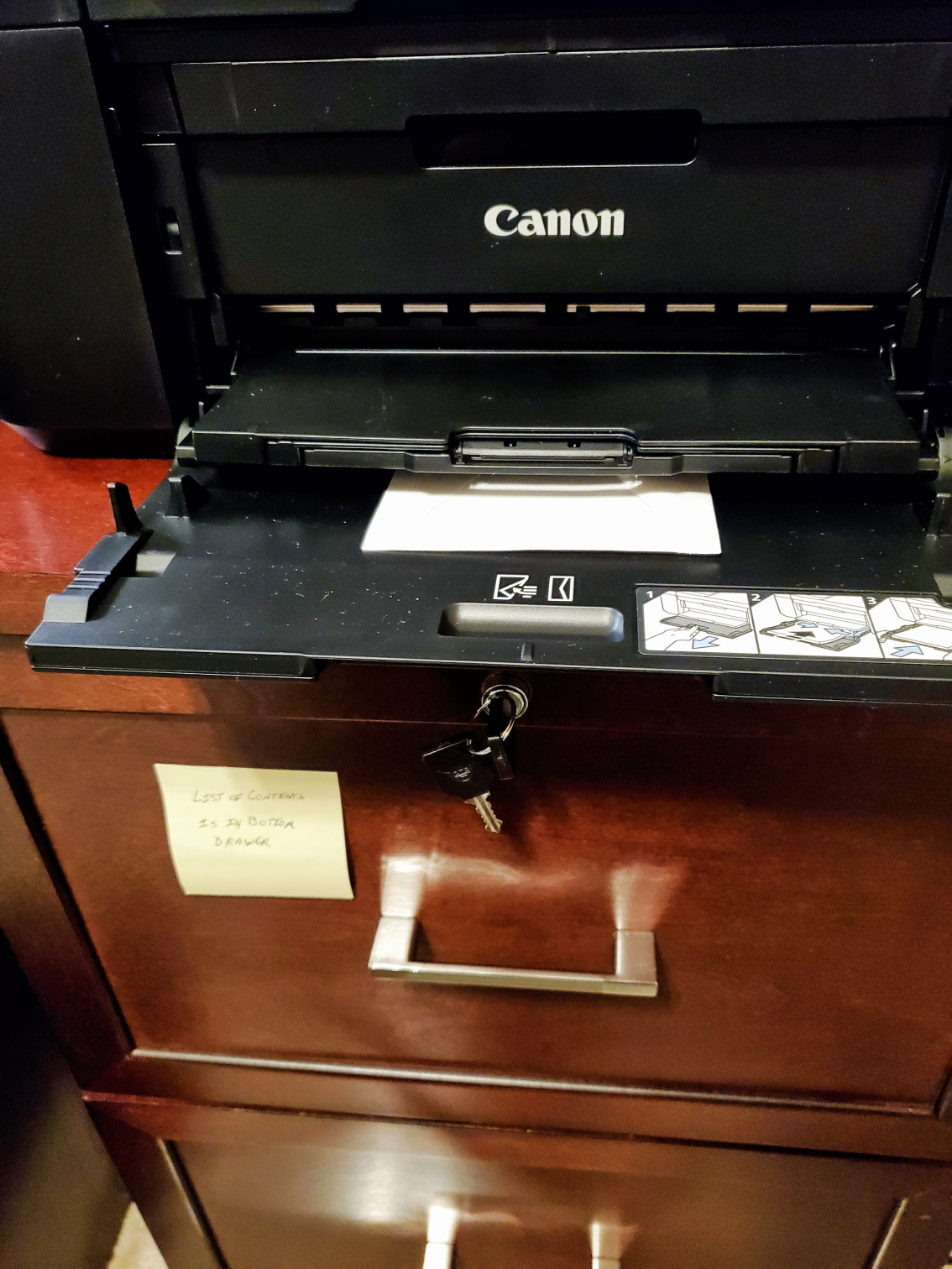

I'm getting "load paper 1003" when I try to print a #10 envelope on the TR4520. I specify the cassette as the paper source. I'm seeing the message on the printer's "menu screen" and a help image on the computer. (I don't know the proper name for the "menu screen.")

It looks like you are not loading the envelopes correctly.
See Page 93 here:
TR4500 series Online Manual (c-wss.com)

I followed the instructions starting at page 93. I noticed that at page 95 "Grab right and left sides...until arrow on front cover and push cassette back until arrow is aigned with edge of printer.", I had to push just a little harder than I had done at first. It nugded back just a bit and I heard it click into place. Also, when I got the envelope properly registered and actually started to print, each time I put in another (blank) envelope, I got a beep when I pushed the cassette back.
So missing that little click was where I got it wrong.
Thank you VERY MUCH for your help, Rick.
