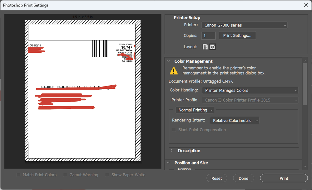

The envelope should be loaded front side up, flap on the bottom. The orientation will depend on the application you are printing from Pitney Bowes?
Once the envelope is loaded, open the printer driver and select envelope. Since you are not using a standard envelope size, you'll need to select custom and manually input the measurements in inches or millimeters. You can use a ruler or tape measure you be exact. The application you are printing from may allow you to specify margins for centering within the printable area. The same applies to orientation. The application should allow you to set which side the flap goes in left/right.

I download the 4x6 and then open it in landscape (default) in Photoshop.
I do not know how to both avoid margins when using the Canon printer and how to use the back feed ramp
Also I cannot figure out what the exact margins are for printing.

Is it necessary to print from photoshop? Use the Canon My print app and choose business document, and set the size to custom using your envelope dimensions.

Can I make a suggestion? You may find it easier to use a word processing program as opposed to Photoshop to print an envelope.
You need the correct app to set up your envelope, one that will allow you to customize it. I use Libre Office, a free drawing program where I can set the EXACT size of anything I want to print and adjust the margins if I want them. You create text blocks and move them to anywhere on the page si you can set the to and return text right where you want it. You should not have to worry about the printer settings because Libre Office gives you total control of the paper. You install the program choose New under file then select drawing and page properties, set the size, orientation, margins and hit okay. At that point you would choose insert from the nav bar, create a text box as the return address, type it in, then create the to: box add an address and save again. Go to file and print set the page size to 4x6 (you can choose printer properties and set it to 4x6 also) then print.

The label is a whole image, I do not manually type in any of this.
02-21-2026 07:39 PM
I understand then my instructions are all the same except you would insert an image instead of a text block and you can adjust the image size by dragging the corners and move it around to fit the envelope.
