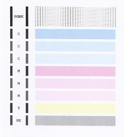

Please print another Nozzle Check and compare it to the example below.
Does your Nozzle Check have the PGBK section at the top, like the example below does?
Does the Nozzle Check also print the BK section at the bottom?

Only shows CCCMMMYBK
No PGBK
Ink status shows ALL ink are at least 60%
Does this tell us something?
Print head is clogged. It is a hardware problem. You need to try deep cleaning. Maybe the printer driver gives an option to only clean the PGBK channel. If so that would save the other inks from being used.
