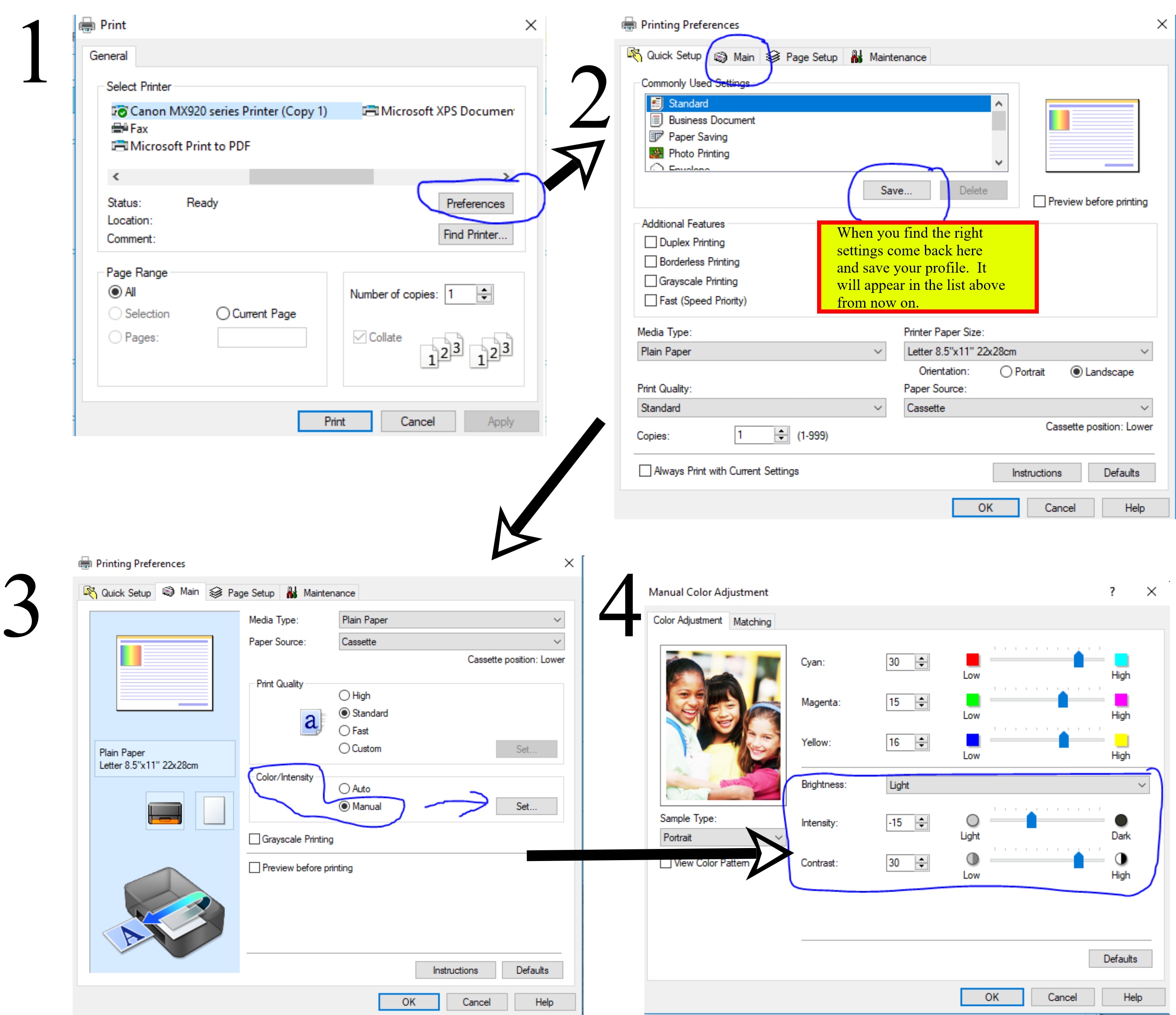

Hi Leesher. YOu have a different model of printer so if these screenshots look a bit different you should still have the same options tabs somewhere on yours. Hopefully this pic I made is not too confusing. Once you get to step 4, that is where you can find intensity and contrast settings. (You have to cick on "maual" just before that page to enable custom settings.
See on the left side of pic for step 4, theres a preview screen. change it to the portrait picture. When you move the settings you can see how the color changes in that picture. I suspect if you have too much orange, the red or yellow or both is too high.
Just don't get too frustrated if it take many tests to get it right. One used up ink cartridge is worth the price once you find the right settings for you.
Canon printers are the best for photo printing in my opinion. But they can be the most complicated too when it comes to tweaking the settings. But that is because many professionals are using them and need those options.
When you do find the right settings, take a screen shot or write it down. You dont want to have to repeat all this if you resintall or get a new computer! :))

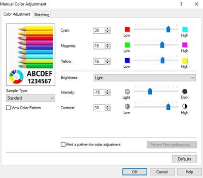

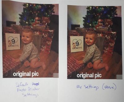

You can try to play with manual color adjustment settings under advanced printer options.
I had to use these custom settings with my MX922 to achieve maximum likeness. I use "Glossy Photo Paper" for media type, and Standard print quality. (im actually printing on normal paper though.
I did a test with your picture. Photo on left, default settings for "Photo Printing". On the right, my custom settings. You can see an improvement. You and I have different printer models but you should still be able to find custom settings that work for you. Be prepared to waste some ink. I would suggest scaling down your photo size to reduce ink used. Looks like you have a contrast (too low) Intensity (too dark) set. My custom settings above are set a little darker than normal (for other reasons)

Thank you, Bucktoof, I'll try what you said, and keep my fingers crossed. The one you tried came out good.
Thanks for the advice.

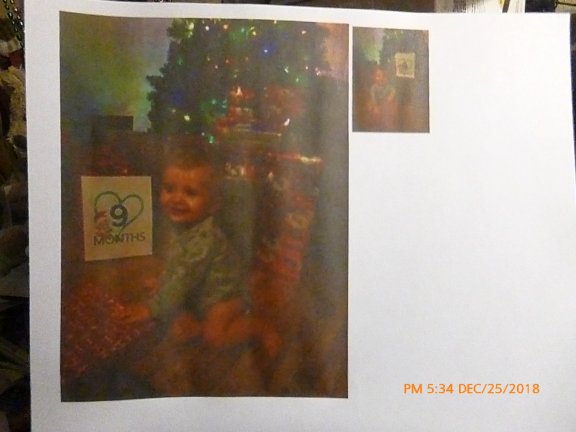

ok, so this is the picture after resetting the colors. It's still dark, and more orange, I'm going to try to play with the colors to get it right..hopefully. That's on regular paper, so glossy may make it better, but it'll still be dark
