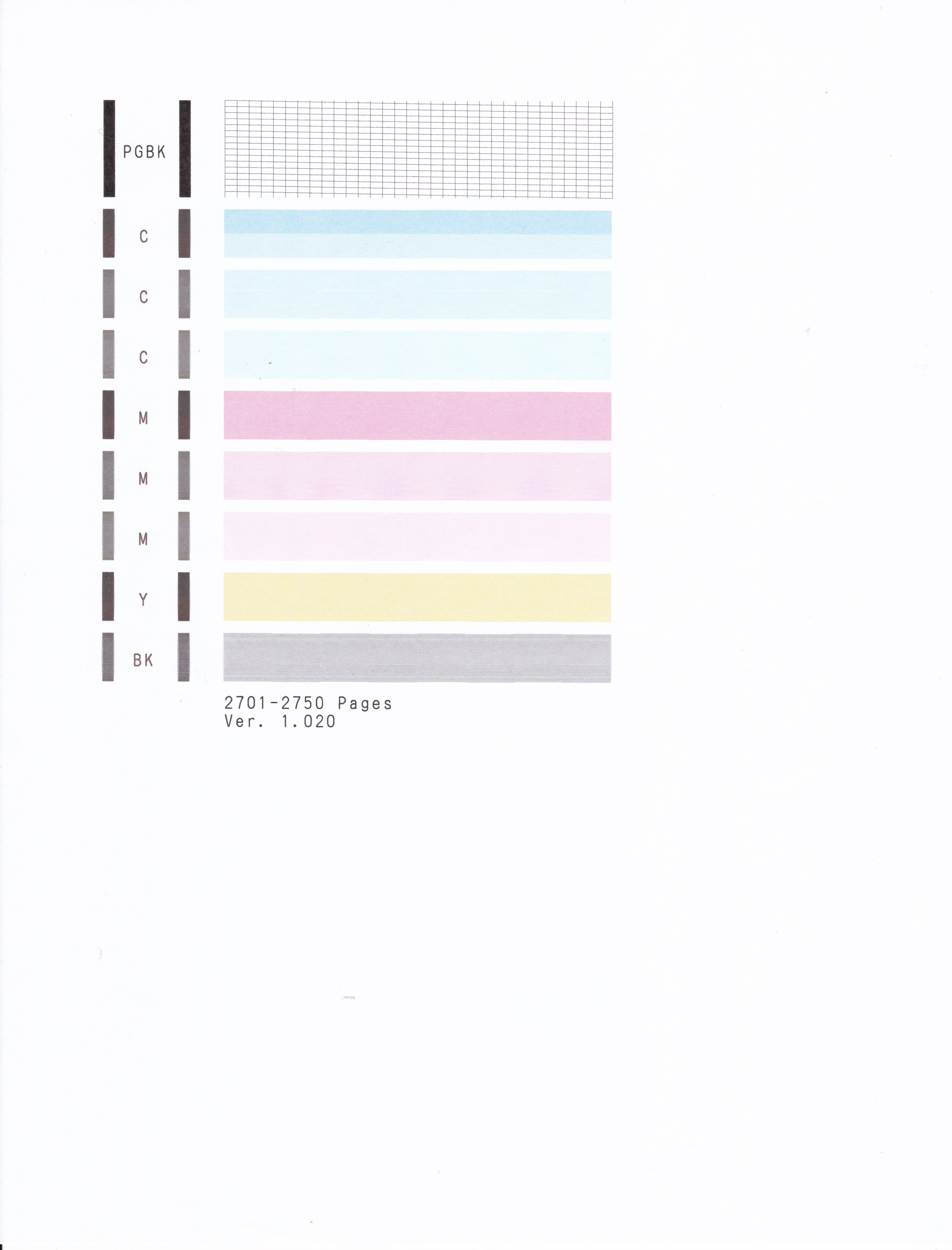

I've been getting stripy prints from my Canon MP560, noticeably with the cyan colour.
I've just run the automatic head adjustment process, "normal" head cleaning cycle followed by a "deep" head cleaning cycle, and there is still a persistent stripe where the top half of the cyan band prints lighter than the top half; comparing with the magenta, I'm assuming this should have a consistently dark appearance. I've inserted a scan of the output, highlighting the problem in a red box.

Does anyone have any suggestions as to what the issue is and how to fix it, please? It doesn't seem to fit the typical descriptions of problems with print heads that I have found and read before posting here.

In the image it looks like some nozzles are clogged or the printhead is not working correctly. In this situation you can try one more deep cleaning to see if the images improve. If the issue continues you can try reseating the print head using the steps in the link provided HERE.

I have removed and replaced the print head as instructed, and have also run another cleaning cycle, and regrettably the problem remains exactly as before.
Is there any way that the print head can be cleaned? A quick search suggested that replacing the print head was probably uneconomical unless there is a way to get a reasonably-priced replacement? I am based in the UK, so I am not sure that the support route you suggest is valid in my case.
