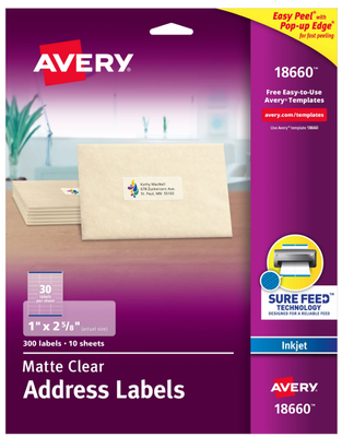

The Avery "framing" is causing the printer sensor to reject the paper.  Peel it off and the label page will print like any other piece of paper.

Since this thread was brought back to life after 16 months, I'll add the following.  I use Microsoft Word to print Avery Mailing labels.  They come with a unique identifier and are printer specific (inkjet or laser).  Here is a guide for set up:
Create and print labels - Microsoft Support
The templates are preconfigured with size, spacing and offset.  You can select the font, size and center or left justify.  If you aren't sure how to load the labels, draw an "X" on a piece of paper and print a test page of your completed labels.
This is one of my favorites.
They look very nice and quality is excellent.
