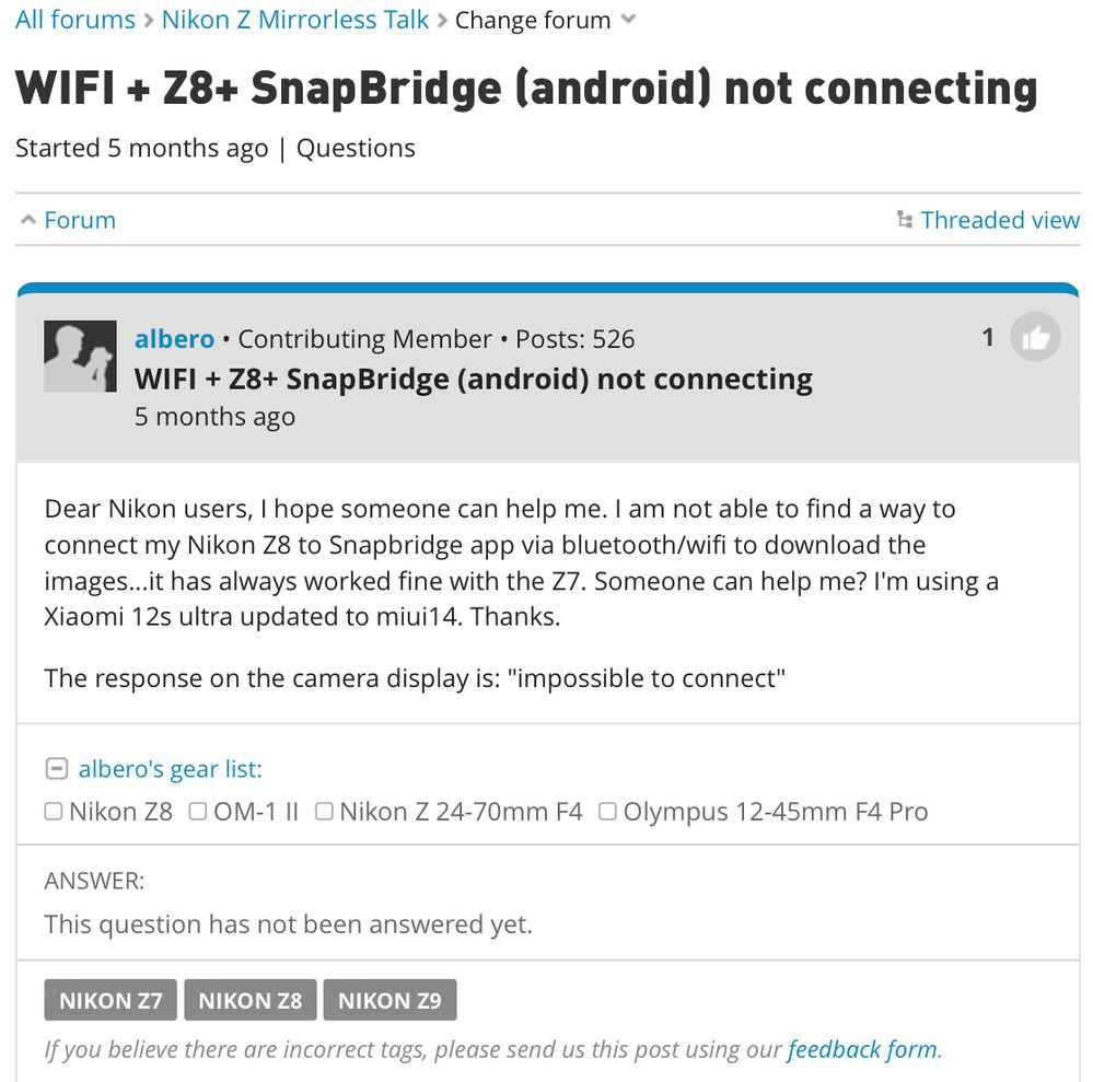

Waddizzle
Every major camera manufacturer has recently been experiencing issues with Android phones.  Nikon and Sony users have had the same issues since December, too.
