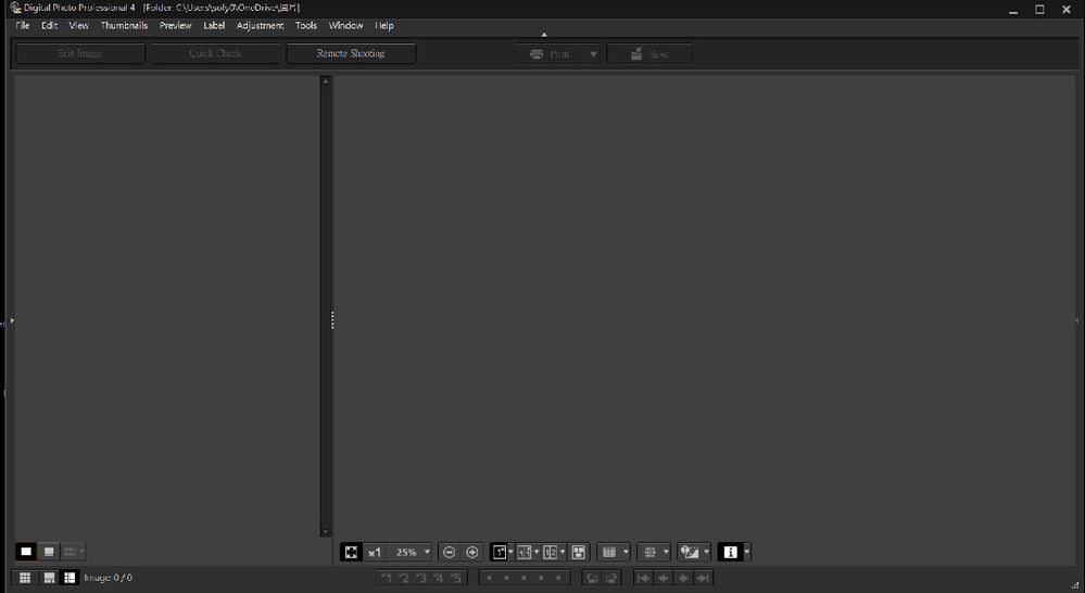

Camera was not used for a few months due to the Covid 19. Take a few shots today but cannot download the images. DPP does not appear when camera is connected to PC, have to open it manually. But it appeared differently as the printscreen hereunder. Cannot download images.
How correct is or do I have to download a new DPP?

2.When it is opened manually, it appears like the printcreen above & cannot download images.
How to correct this issue, please or do I have to download a new DPP4?

EOS utility is used to connect the camera and download the images and then DPP is used for editing and conversion to JPG.
I suspect a windows update changed the auto start settings of EOS utility causing the change in your system behavior. I use the ethernet port to connect my 1DX series cameras and after an update a few months ago I had to go back in and setup the networking parameters for it to work.

I re-installed the DPP. Doesn't help at all. It cannot read the camera when it is opened manually.
12-05-2021 02:50 PM - edited 12-05-2021 02:50 PM
You need to install EOS utility or if it is on your system, launch it manually. EOS utility is used to communicate with the camera, NOT DPP. This link will tank you to the Canon site where you can download the latest version of EOS utility: https://www.usa.canon.com/internet/portal/us/home/support/self-help-center/eos-utility
