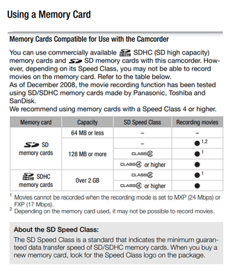

I just bought two new memory cards, and neither one will initialize correctly on my camcorder... it goes through the process on the screen, but afterward, it seems like nothing has changed, and it says the cards still need to be initialized.  One is an Onn 256gb (U3), the other is a SanDisk 64gb (U1).  Not sure what information to provide, but hopefully someone can help...  🙂

The maximum card size for that camcorder is 32GB. and they use the FAT file system. You must format the cards in the camcorder and not your computer as this can cause recording problems.

Here are the requirements for your camera:
CamraMaan
I appreciate the info, but I saw the same in my manual before I purchased the cards.  They're both class 10, so I figured that shouldn't be the issue...?
I'm also curious what file system to format the memory cards in, if using my computer?  It defaults to exFAT, so I just want to make sure that's not the problem?
Again, thanks for any/all help!  🙂
I should add that the camera recognizes and uses similar, but older, memory cards just fine, but none are larger than 32 GB.

Thank you!  I had a feeling 32 GB was a max.  Sad day...  😞
