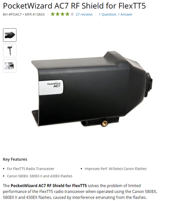

I can find nothing about noise flash sleeve anywhere. Can you provide a link?
11-09-2022
12:55 PM
02-17-2023
09:31 AM
[Commercial link removed per forum guidelines and replaced with screenshot to facilitate discussion.]
11-09-2022 01:41 PM
Pocket Wizard make (or made) 2 versions. The AC5 is effectively a sock which covers the entire flash, including controls.
The AC7 is a hard shell that I haven't seen until today. It would appear to be open at the back but would appear to only allow the flash to be used in the "straight up position". This would probably ok for most purposes if using stands. However, the rigid shell of the AC7 might not be compatible with the form factor of the 600RT series flashes - this would need to be verified.
Bear in mind that they were intended to reduce interference from the flash unit. They are RF shields. Blocking RF leaving or entering the flash is likely to reduce the range or may even completely prevent the communication. If you want to try this idea I'd just start by trying it on just one flash first, before investing on a complete set.

Got my AC5 sock in today. Testing tomorrow!
