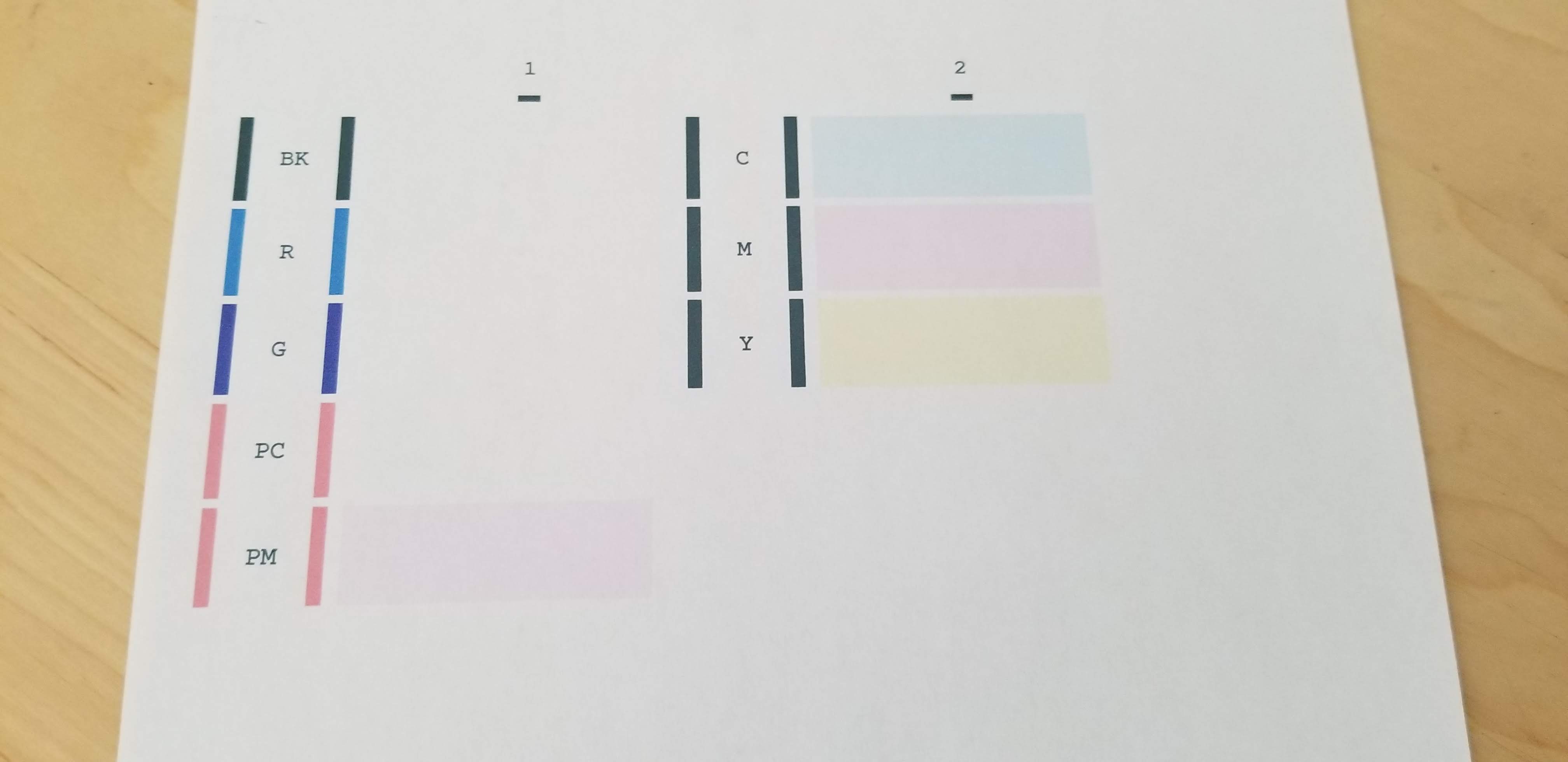

Replaced the green tank with another (and yes, all of them are genuine Canon inks).  No change.  Tried clean and deep clean, no change.  Ran a nozzle check page - looks like this:
Weird colors and bars missing on several in bank 1.

You could try unlatching and reseating the print head, but it looks like the head has malfunctioned. Could be a coincidence is guess; no reason just changing a cartridge should cause what you are seeing.

Once all of the empty ink tanks are replaced, please print another nozzle check.  If the nozzle check does not print correctly, please perform 2 deep cleanings.  If the nozzle check still does not print correctly, your PIXMA Pro9000 would require service.
You are eligible for Canon's Upgrade Program. This is for out of warranty units which have been diagnosed to require service, or for some reason are incompatible with a new or upgraded system. This option allows you a one-time opportunity to purchase a replacement product, discounted from the list price.
To help you get up and running quickly, we also offer free standard shipping (if the order is completed by 12:30 PM ET). If you would like to take part in this option, please call our Sales Department at (866) 443-8002 weekdays and Saturdays after 11 AM ET (8 AM PT). Let them know you have been working with technical support and the Canon Upgrade Program was offered.
Tried it - same result.
