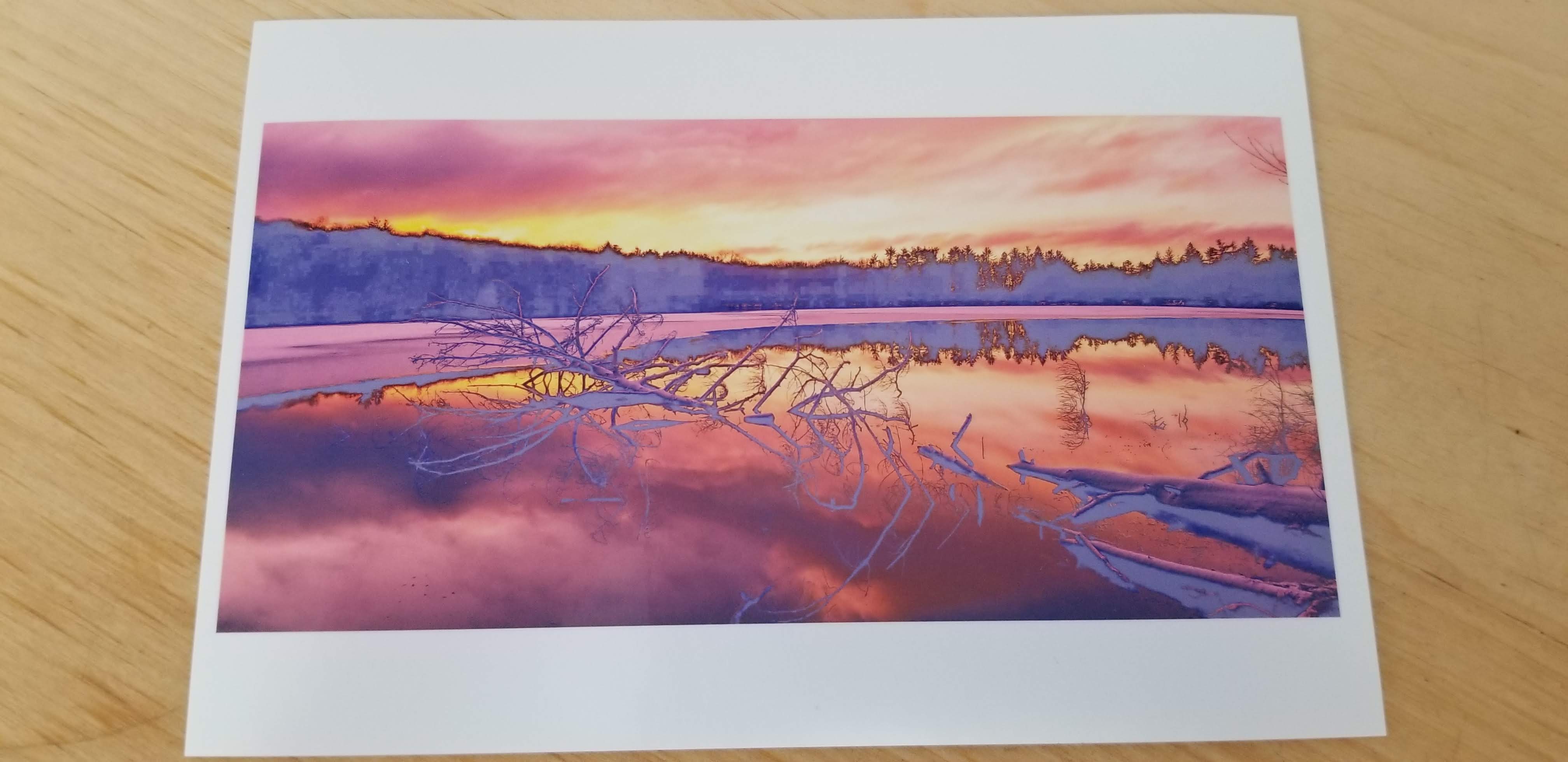

Green ran out.  I had a spare.  Put it in.  Colors WAY off, as in:
printing as:

Uninstalled and reinstalled the driver (WIn10) - same.  Oddly, SOMETIMES spot color prints correctly out of Word (including green) and sometime it doesn't (green prints as yellow or blue).  Photos out of Photoshop are always bad, regardless of color match or paper settings.

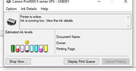

Can you print a screen shot of the ink level page?

It complained it was running out, it finally said green was out and stopped printing, at which I took the green from my cabinet, unwrapped it, and installed it.  Ink level showed fine.  This is no different from what I've done countless times before.
