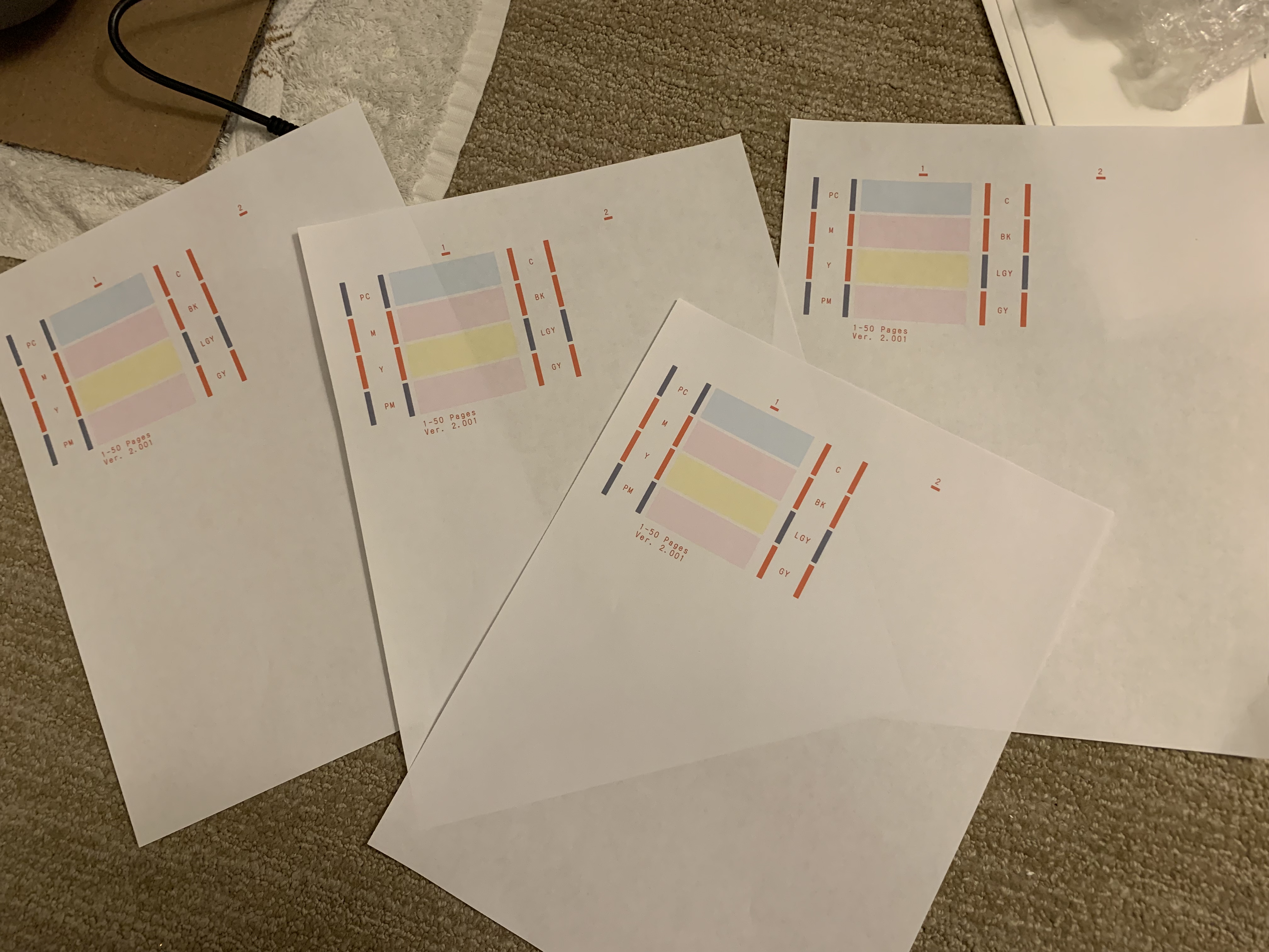

However when I setup the PRO-100, in the nozzle check only Group 1 colors are printing. None of the Group 2 colors are printing at all. I'm not sure why. I did cleaning and deep cleaning, but it didn't help at all. I also took out all the ink cartridges and the print head, and re-seated it. Still not difference.
Is the printer busted, or is the print head busted, or something else ?
One more thing. When I got the printer, the previous owner had ripped opened the aluminum packaging of the print head, although its orange plastic seal was still on. She said she opened the aluminum packaging an hour or so before I collected the printer from her.
See attached picture of the nozzle check result.

What does the nozzle ceck say for number of pages?
09-20-2019 06:16 AM - edited 09-20-2019 06:17 AM
I think you mean the thing printed below the nozzle check pattern right ?
It says:
1-50 Pages
Ver. 2.001
I actually contacted her about this issue and she apologized. She says she will come by in a few days and take the printer back if I can't get it to work, and refund me my money. Let's see.
But for now, can I fix/diagnose this issue ?
09-20-2019 06:26 AM
You performed all the correct troubleshooting by reseating the head and verifying that the cartridges were properly seated.
Very possible that the printer is defective. There are a number of web postings about Group 2 problems.
