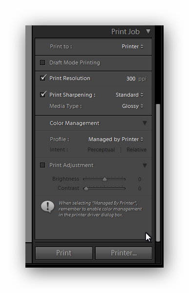

And, thank you so kindly for responding with such helpful information. Now, I did have my printer's color management set to none. However, I am still uncertain as to what lightroom settings should look like. See attached photo.
The above photoshows my current settings. If you would be kind enough to give me your reccommended settings for lightroom, I would feel much better.

You have selected "Managed by Printer" in LR.
You want to select a paper profile.
If you don't see the paper you want select Other to add to the list.
