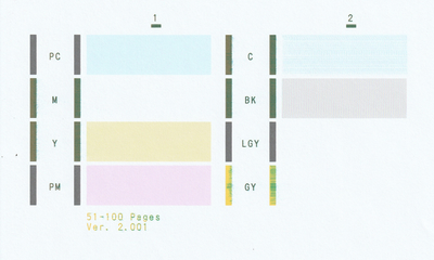

I haven't used this printer for awhile since I recently purchased a Canon TR8622.  However, when I tried to compare prints from both devices I discovered that the Pro-100 had gone completely out of whack as you can see from the nozzle check printout below.  Magenta, light gray and gray colors aren't even appearing.  The vertical bar next to the gray color is an odd assortment of yellow and green lines.
As you can imagine the prints are coming out in atrocious colors.

Some channels aren’t printing. Looks like you printed less than 100 pages.
Remove one of the cartridges that aren’t printing and touch the ink port on the bottom. If ink gets on your fingers it means the cartridge is OK and the head is probably blocked. If the cartridge doesn’t ink your fingers wet a paper towel and try and dissolve dried ink in the port.
I am assuming when you remove the cartridge it has ink in it.

John,
I'm almost too embarrassed to admit this, but when I replaced these cartridges recently I had forgotten to remove the adhesive strip.  As soon as I removed that and ran a nozzle check, it worked perfectly again.  Entirely my bad.  Thanks so much for your prompt and helpful advice.
