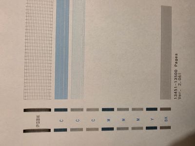

PIXMA MX922 Misaligned print, missing colors
nvtkikid1993
How to fix this?
1 REPLY 1

Common Issues with PIXMA MX922
Misalignment and Missing Colors
The Canon PIXMA MX922 can experience print quality issues, including misalignment and missing colors. These problems are often linked to the print head, which is responsible for distributing ink accurately.
Signs of Print Head Issues
  • Missing Colors: If specific colors like magenta or cyan are not printing, the print head may be clogged.
  • Streaks or Lines: Streaks in prints can indicate that the nozzles are blocked or that the print head is failing.
  • Error Messages: The printer may display error codes related to print head failure, suggesting that cleaning won't resolve the issue.
Troubleshooting Steps
  1. Cleaning the Print Head: Run the printer's cleaning cycle to unclog the nozzles. If this does not work, consider a deep cleaning cycle.
  2. Manual Alignment: Perform a manual print head alignment to ensure the nozzles are correctly positioned.
  3. Check Ink Cartridges: Ensure that the ink cartridges are full and properly installed. Sometimes, replacing cartridges can help.
  4. Print Head Replacement: If issues persist after cleaning and alignment, the print head may need to be replaced. This is often the most effective solution for persistent problems.
