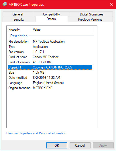

I have a MF4570dn, and recently upgraded from Windows 8.1 to Windows 10.
I can no longer scan using the MF Toolbox utility. I had MF Toolbox 4.9 installed before the upgrade, and it worked just fine. After the upgrade, I get "Cannot communicate with the scanner" error dialog:

First, as I recall, the major Windows 10 update that broke scanning for my MF4150 was named 1511.
While PiersA's info was instructive, nothing I tried worked long. I have a solution that seems to work quite well for me. I always faithfully reinstalled MF Toolbix, though it was never clear that I was actually using it. Turns out, it was breaking my scan function and I was NOT using it.
Focusing on the apparent fact that the hardware is functioning, I 1) disconnected the printer/scanner, 2) uninstalled the MF Toolbox and drivers, 3) restarted the computer and 4) reconnected the printer/scanner. Windows recognized the hardware and installed drivers. From the devices and printers manager in the Control Panel, right-click the printer and use the Start Scan command. Seems to work every time.
I also reinstalled and upgraded the Presto PageManager 7.15.xxx which came with my Canon hardware. It, too, works AS LONG AS I DON'T INSTALL MF ToolBox. Manufacturers often include worthless "added-value software" to differentiate their hardware. I find that the Presto PageManager (also provided by Canon) has much greater value and still works.
